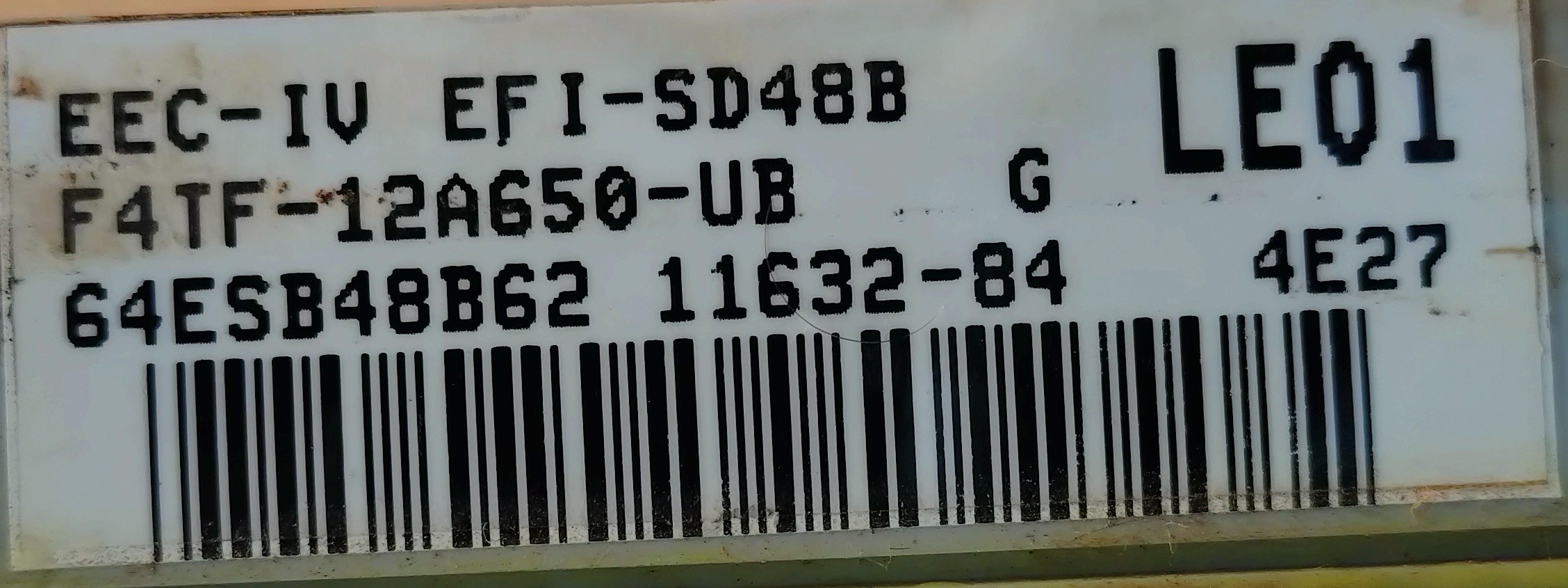

Came into another sd48B, with stock bin LE01. Is it just me, or are the 351w tunes (LAD1, KID2, and this LE01) not reading on the A1C.xdf?

Posts: 7006
Re: [Wanted] 351W E4OD stock tune
they arent going to its a different strategy
you have to use the a1c files provided in that thread
yaboyhalle wrote: 2025 Aug 12, 22:38 Came into another sd48B, with stock bin LE01. Is it just me, or are the 351w tunes (LAD1, KID2, and this LE01) not reading on the A1C.xdf?
Thats L - lima E - echo O - oscar - 1 (LEO1), not LE zero one(LE01).
That is 100% identical to KID2, exactly.
Very different than A1C.

It seems a bit too thin to be an Oh, but I wouldn't know what font they're using. Either way, I was just looking to find an A1C bin for a 351, as adapting a 302 tune isn't as easy.
The O do not have a line through them like the zeros.
Googling these codes, makes a difference.
I tend to be a bit pedantic with this stuff.
yaboyhalle wrote: 2025 Aug 29, 20:19 It seems a bit too thin to be an Oh, but I wouldn't know what font they're using. Either way, I was just looking to find an A1C bin for a 351, as adapting a 302 tune isn't as easy.
The A1C.bin is located in the first post of this group.
You must use the matching XDF.
