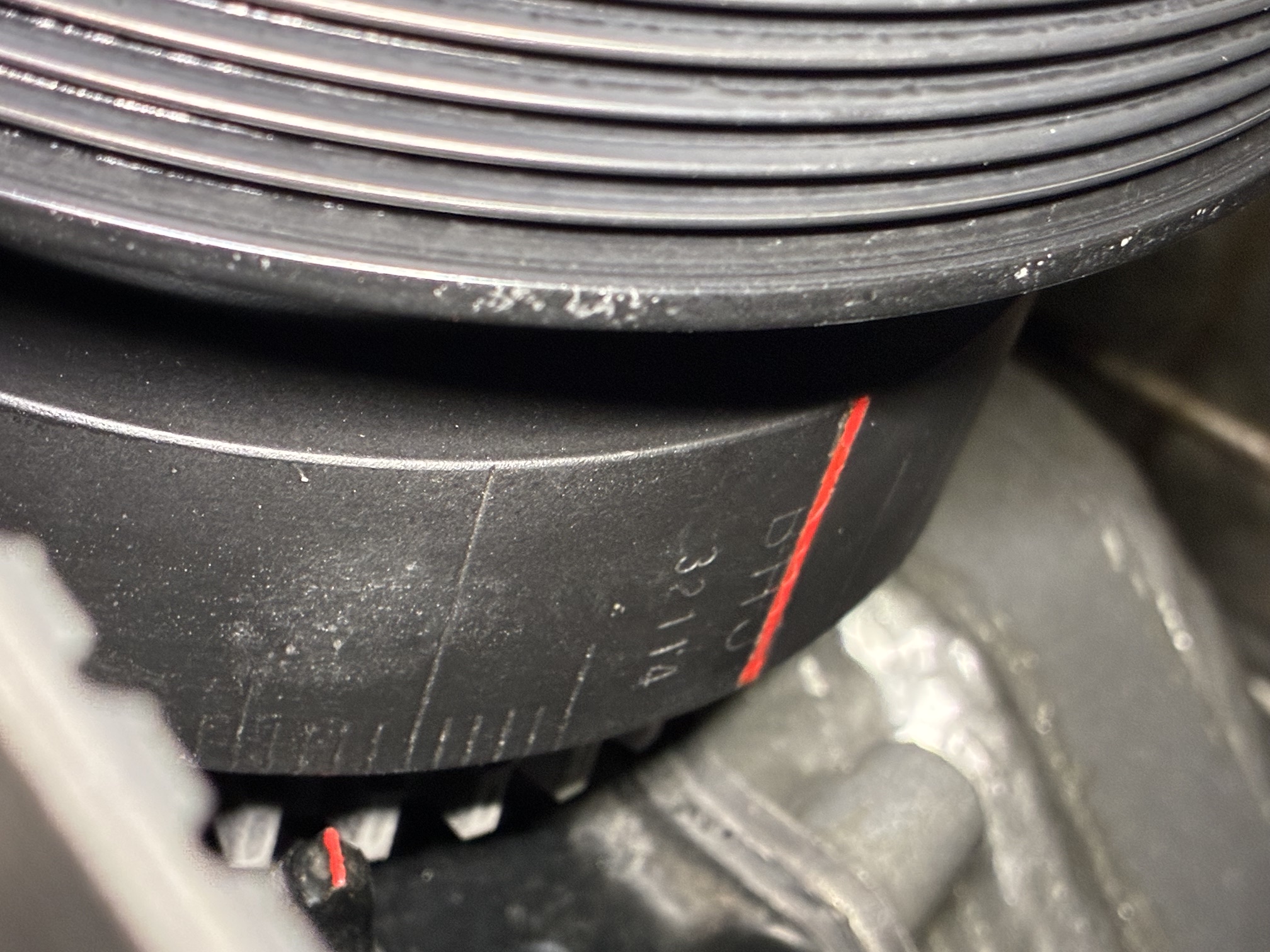

I have sync. I skipped a tooth at a time all the way around while spinning the cam sensor and nothing. I ordered some new parts along with 2 new cam sensors and started all over again. I notice sync turned white I found the middle and bolted it down. swapped the OEM sensor on and no sync, in the trash it went. looks like its rising and not on falling, need to look into that but pretty sure you can't get sync 180' out.
Maybe this will help someone. First the window is so small for the eec to sync I don't see how any 3.8 still running at this point is in sync.
Here we are #1 compression stroke 26' atdc on my early BHJ dampener that never had this mark. I used my OEM dampener keyed them together and made this mark. Here is where the cam sensor wants to be to sync. Its close but if you get it to the point the tool fits its no where close to being in sync. So next I spun the crank around until the cam tool fit and I wanted to know where the crank pointer is. Its closer to TDC then it is to 26' atdc but still would never synce if you installed it at TDC. And here is my scope when in sync

Very nice, Its been a while since I've done it but i don't think its supposed to be at tdc. iirc you go to 26 degrees, make sure it was on intake? and put the invert U in the middle of the window. There was a write up for it on sccoa. I've never used the tool before never found a need for it. I always verified and I've never had one not sync.

As for sync I see why Ford sent out the TSB saying you need to use WDS to set cam sensor and not the tool.
