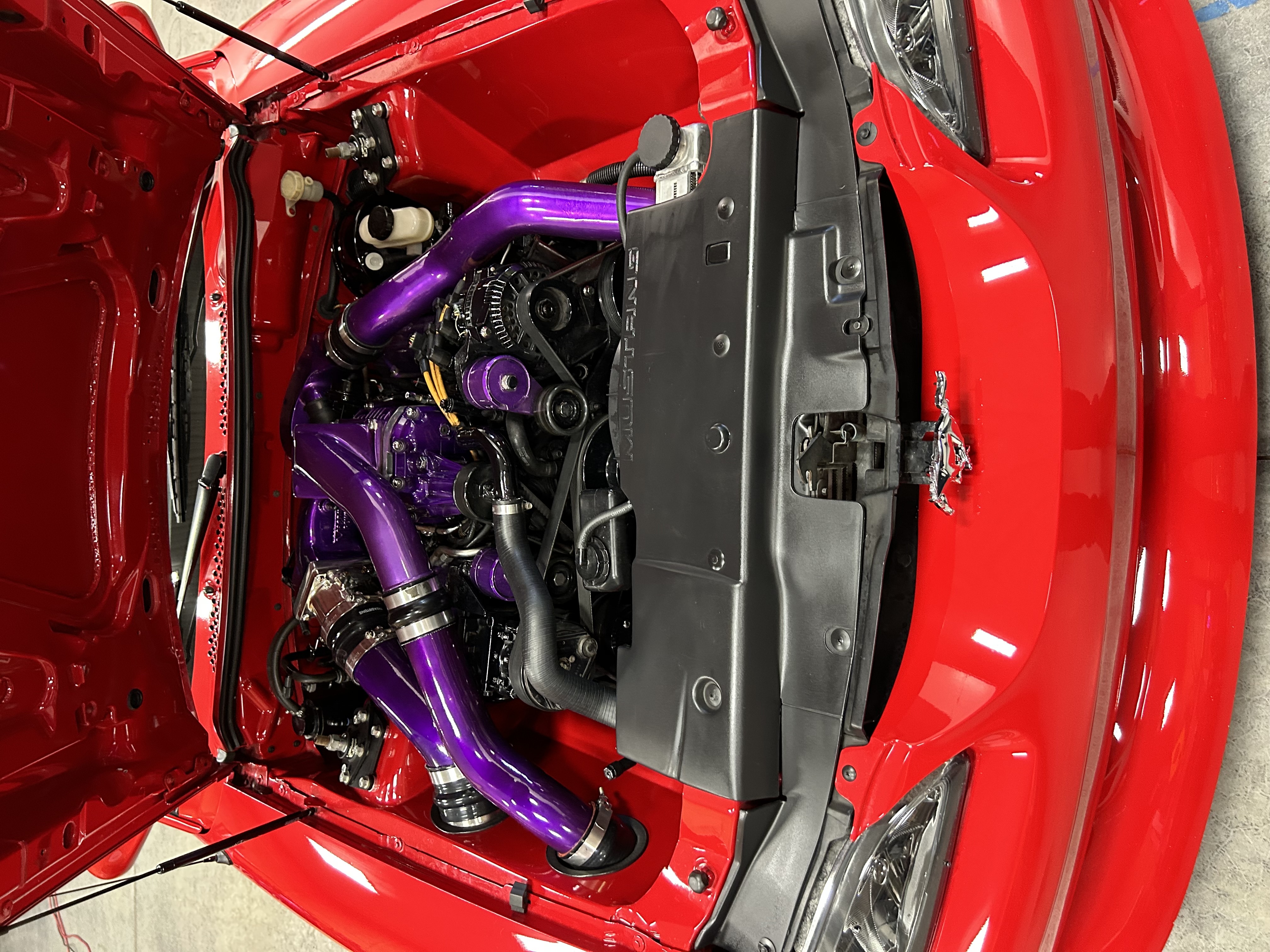

I have had this SC powered mustang since the late 90s. It was never close to driving a factory car but I enjoyed it for many years. I pulled the driveline to correct everything I knew was wrong and to check on the health of the motor.
The cam is a regrind and I struggled to degree it last time. I have no idea where it was installed but the cam was ground 14' retarded if installed straight up. I had to skip teeth to get it the best I could at 2' retarded. My vacuum went down at idle but power went way up in boost, seat of the pants.

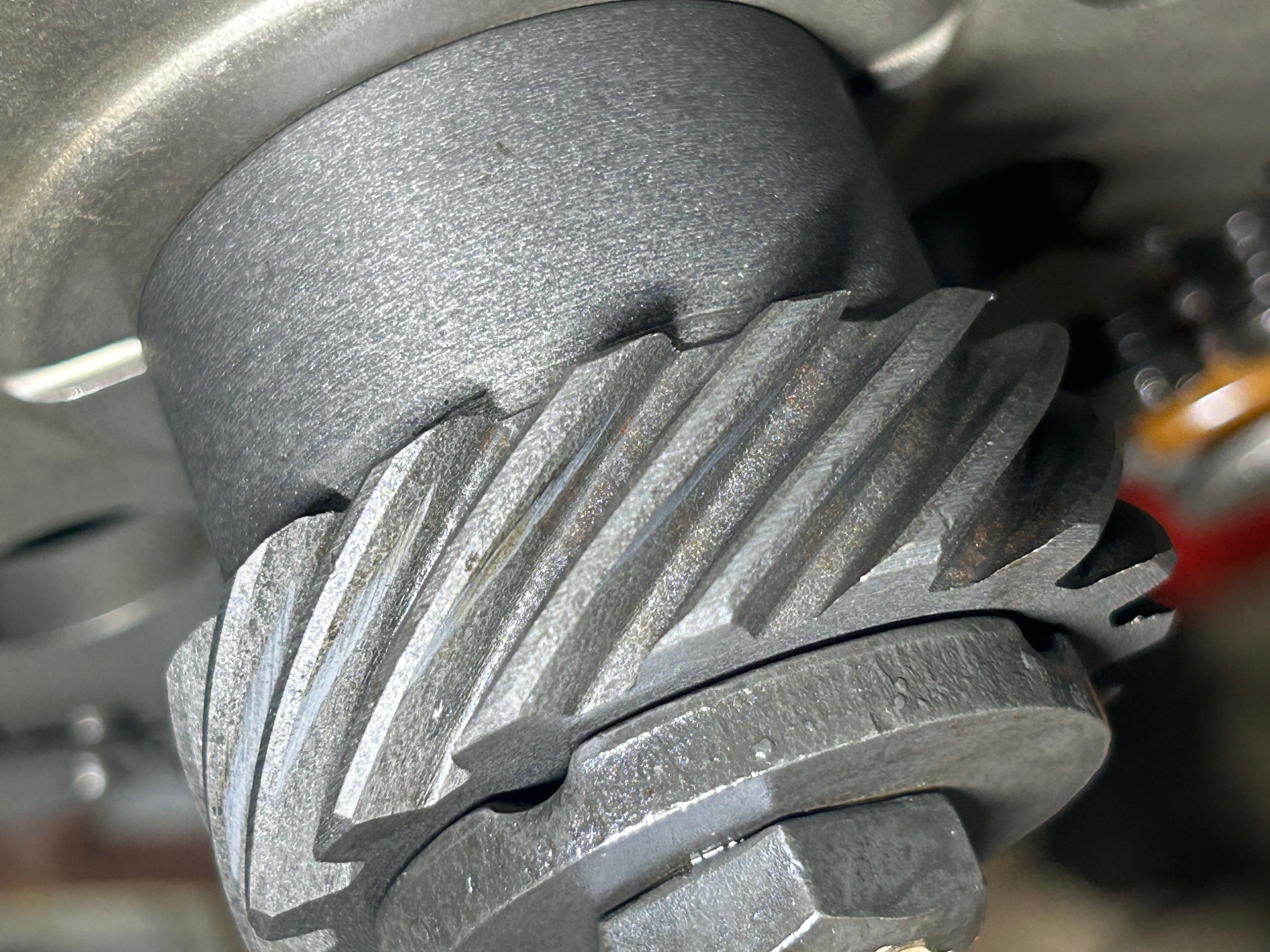

I found the cam gear worn to knife blades with 60k miles on it. Pulled the original one from the 3.8 NA engine that had maybe 30k miles on it. I did pull the SC oil pump off and used the 3.8 NA pump to reduce the wear on this gear. I only run 5-30 mobil 1, engine RPM is always low and the cam sensor bushing is in great shape with only 60k miles. Still confused why this happened but I did machine some off the back of the hub to get the gear alignment better. Have to wait and see if this is resolved. Oil pressure is still more then enough with the smaller gears. Put new rod and main bearings in it since the metal from that gear did some damage.
