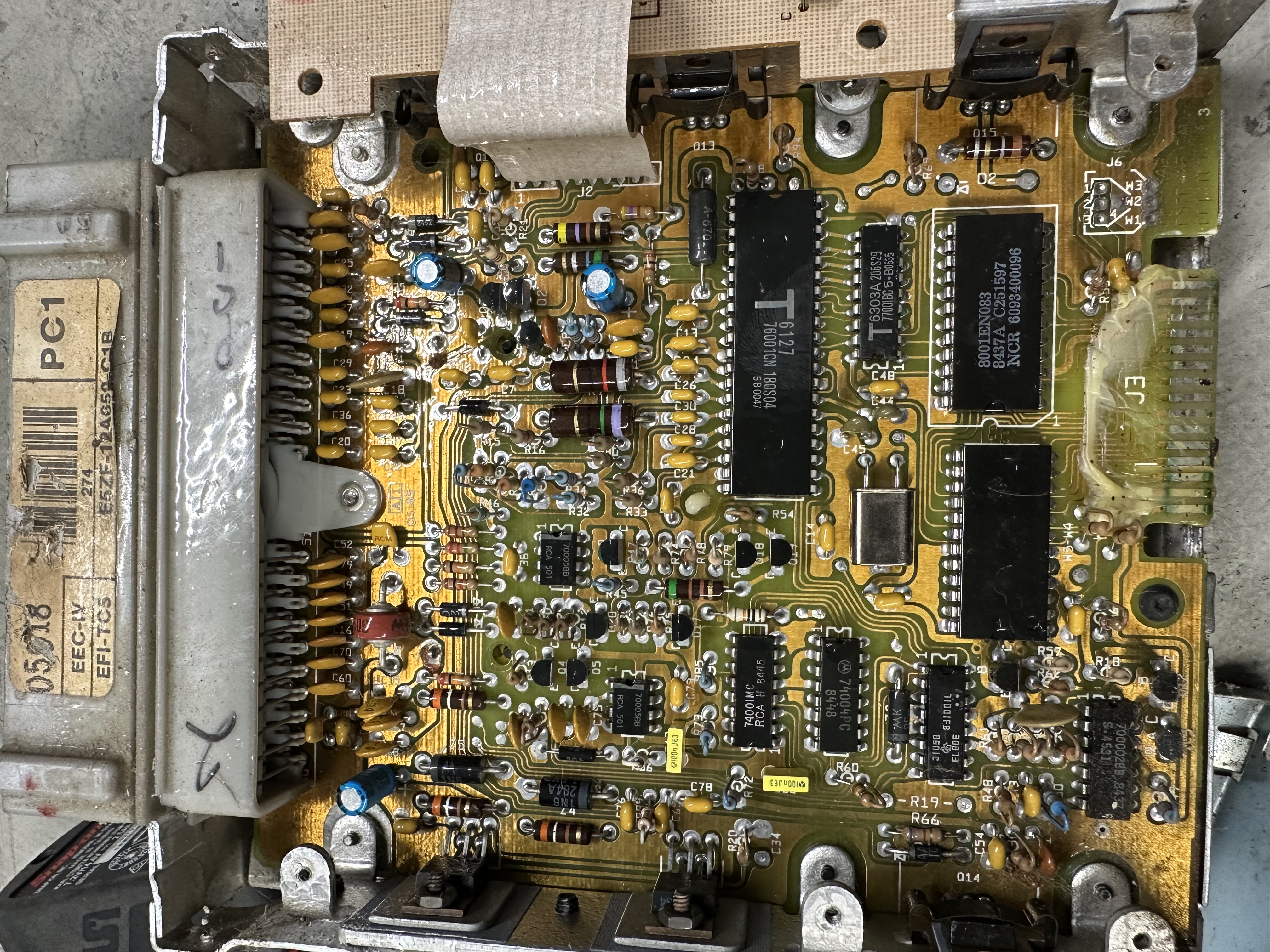

Posts: 437
Joined: 2023 Sep 06, 13:11
Location: Charlotte NC , USA
Re: Clock speeds of any/all boxes

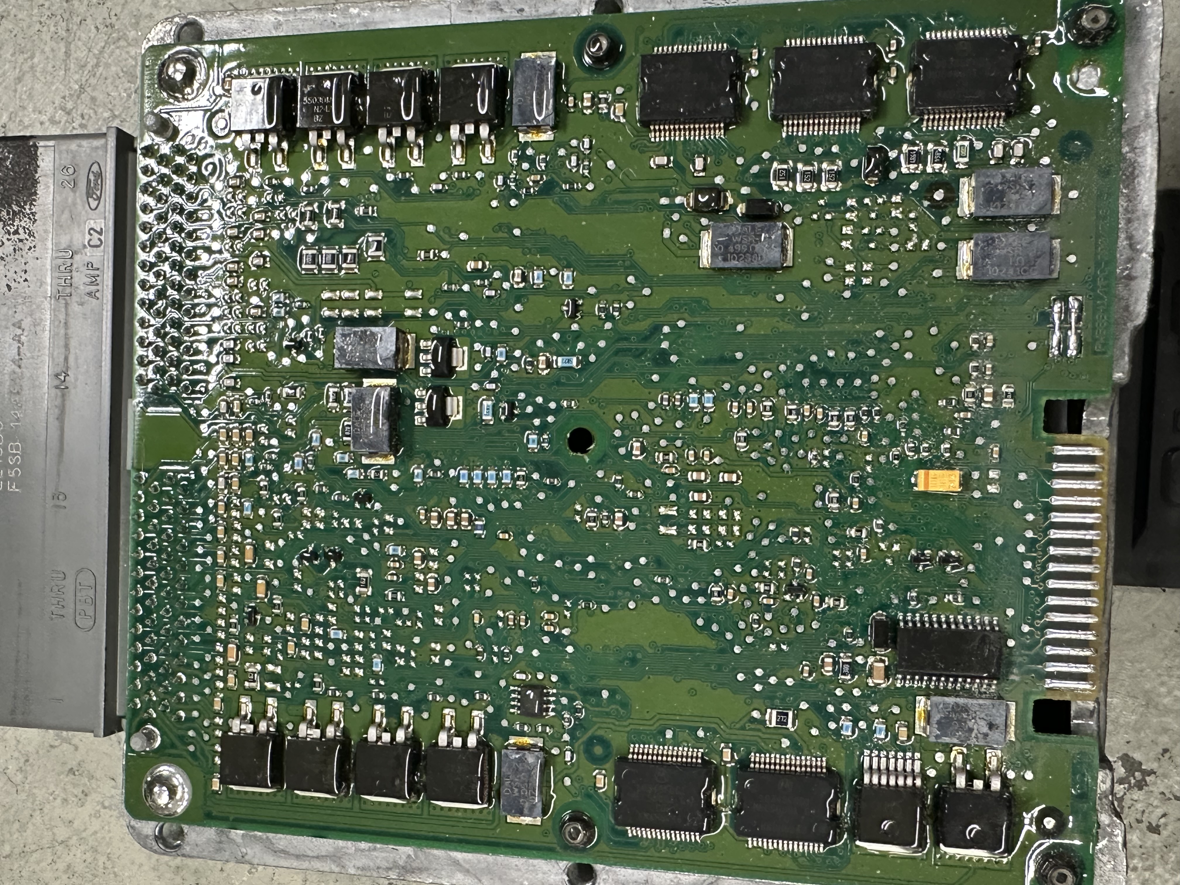

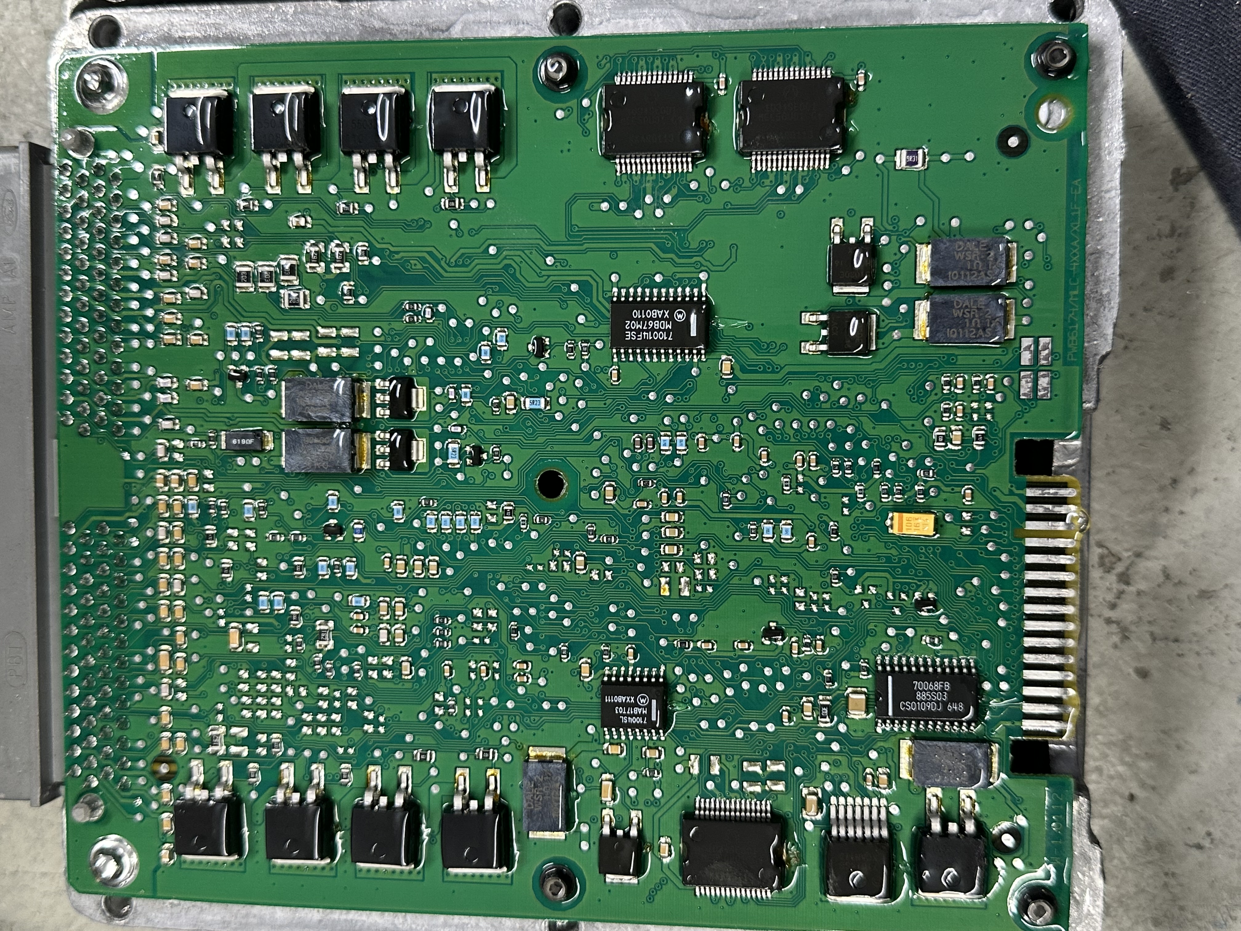

Here are a few. I have a few more that I’ll post up in a bit.

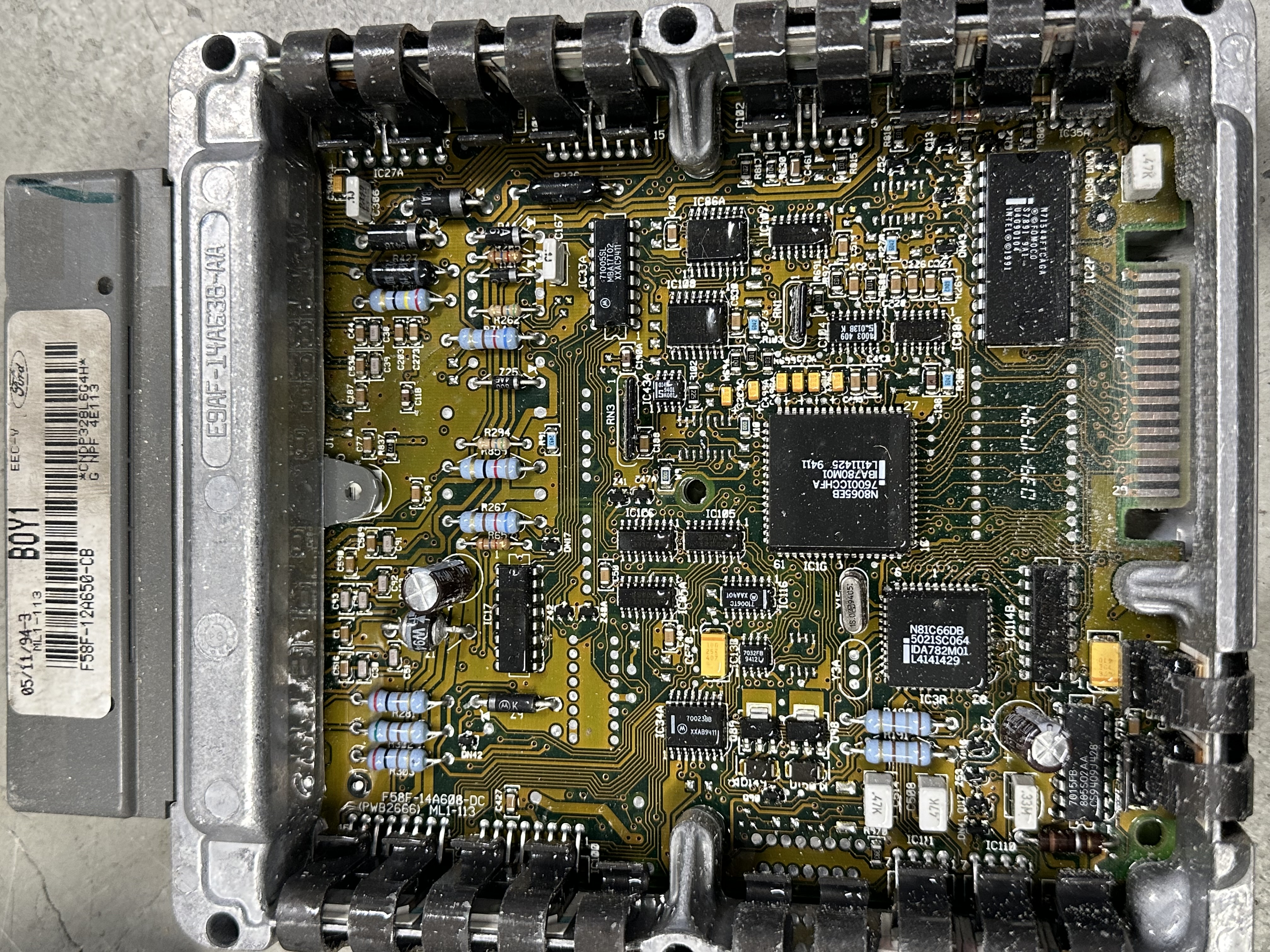

Posts: 437

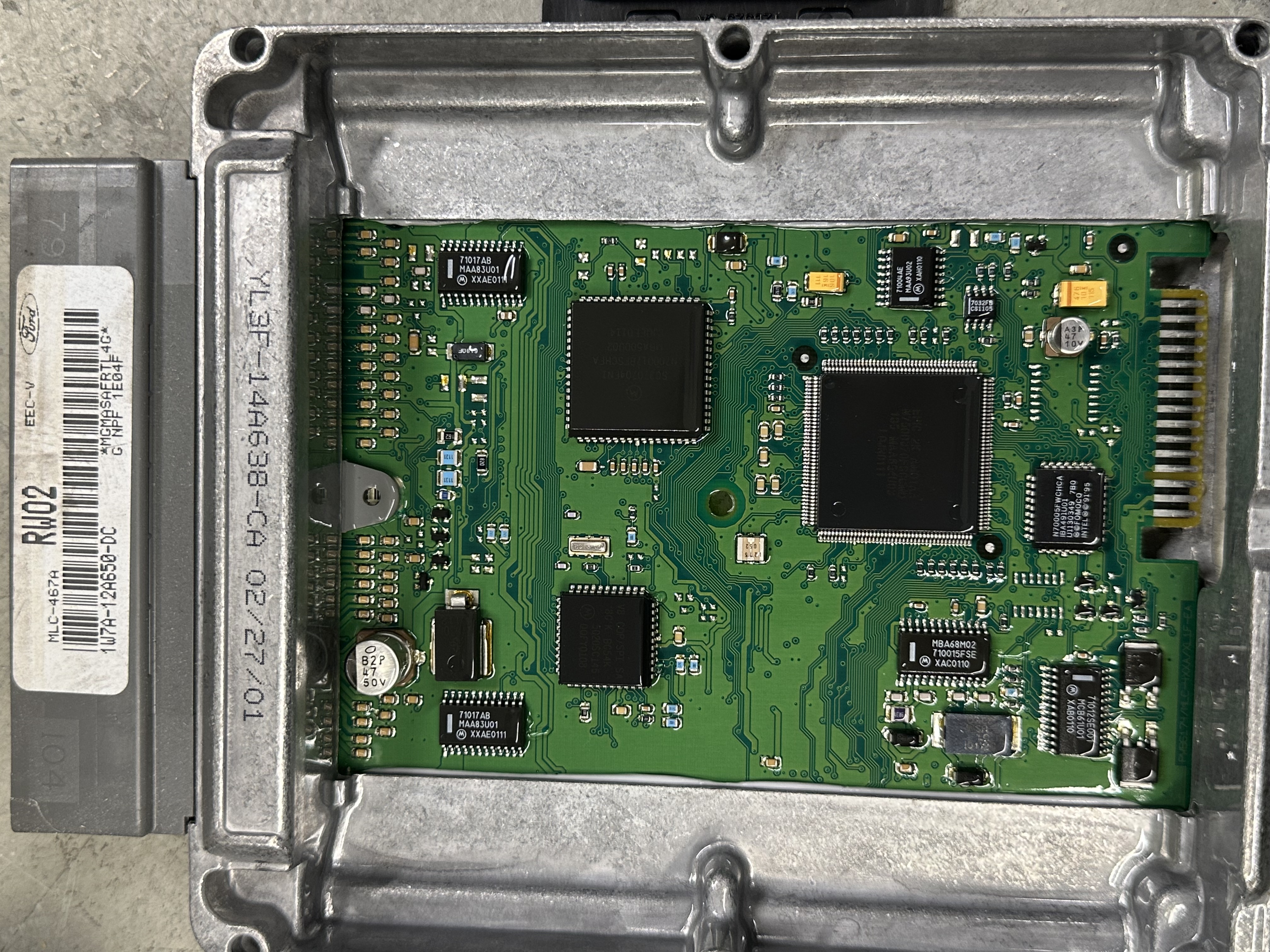

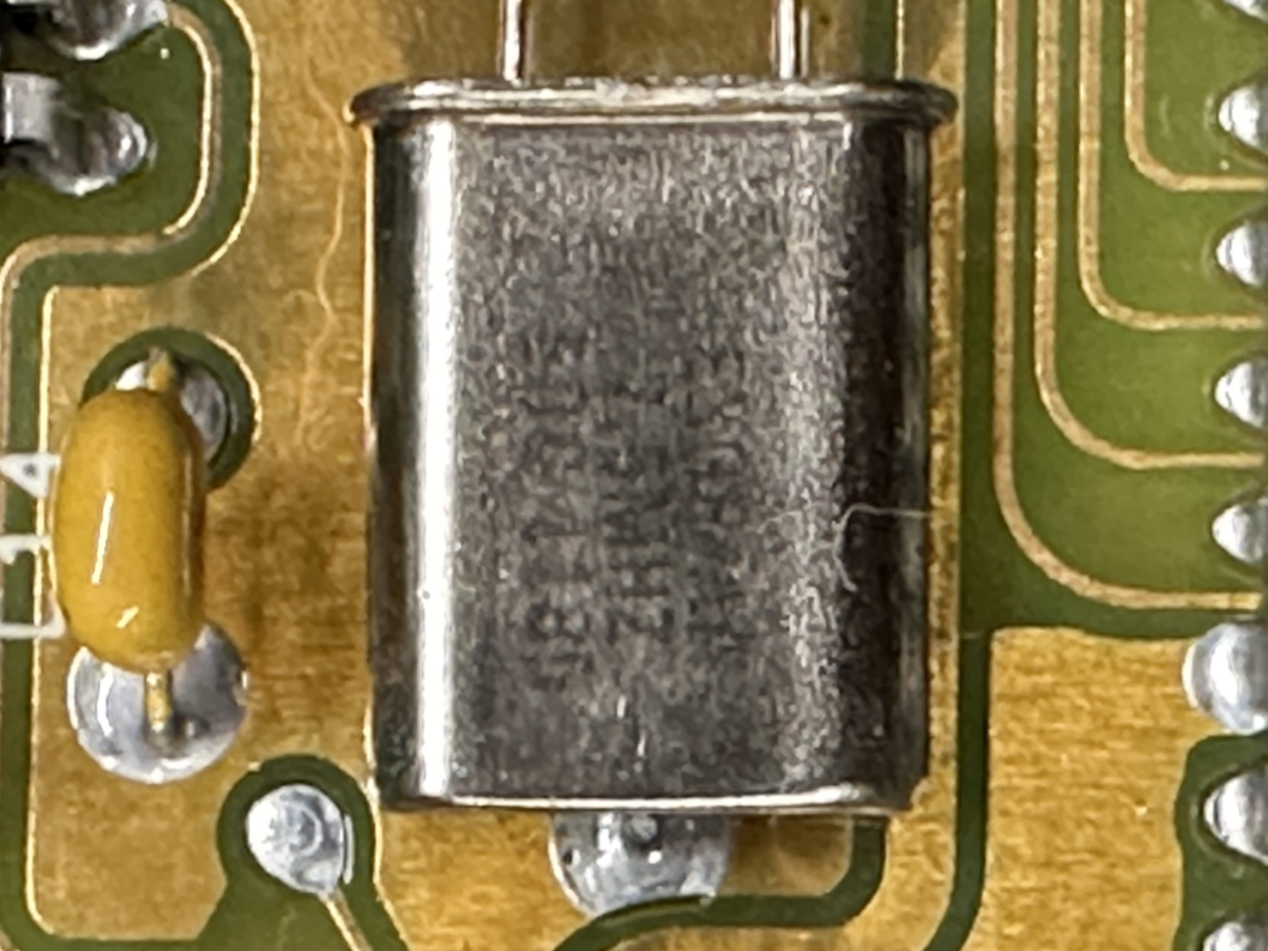

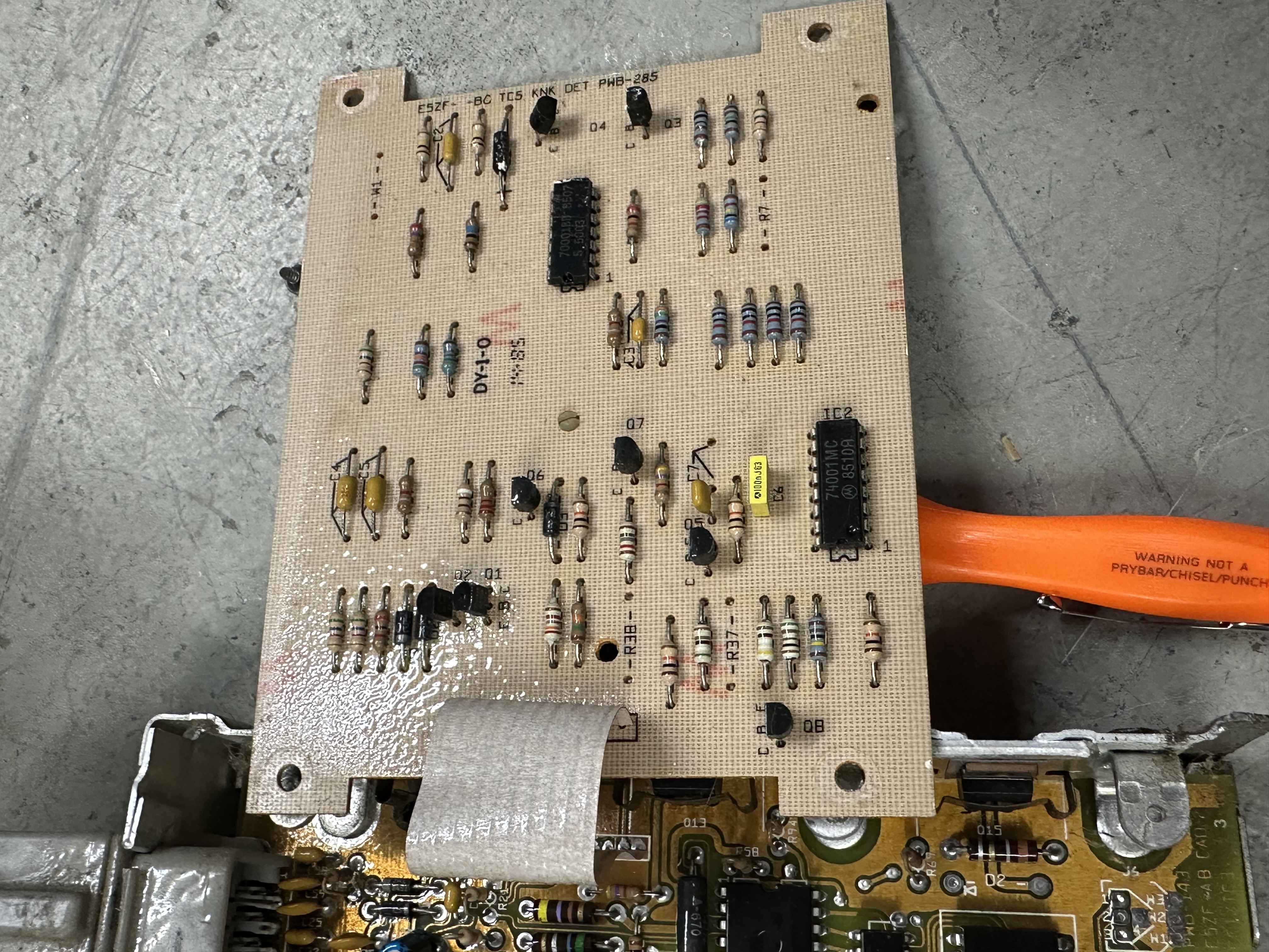

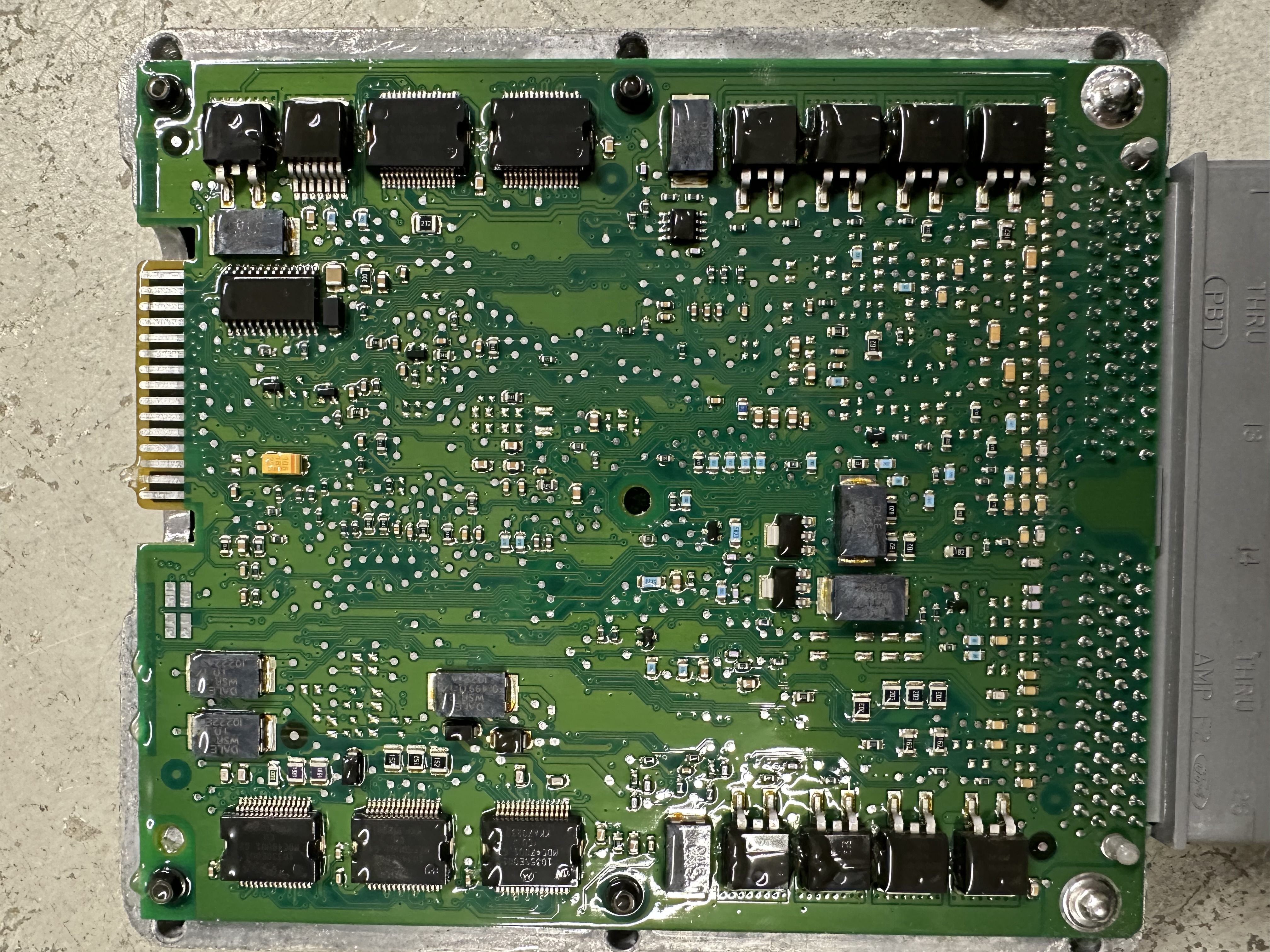

And the rest. Let me know if you need close ups of anything.
