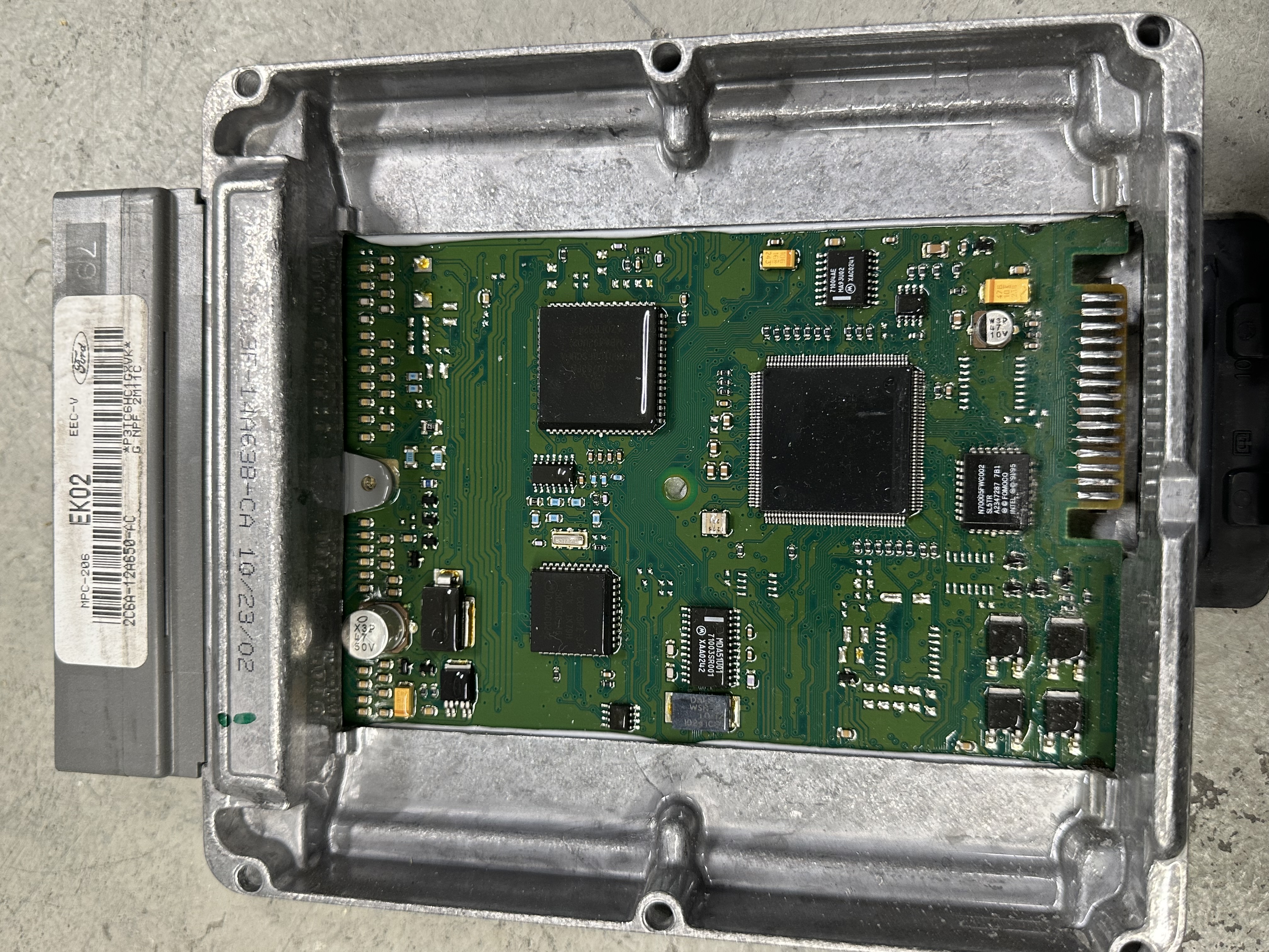

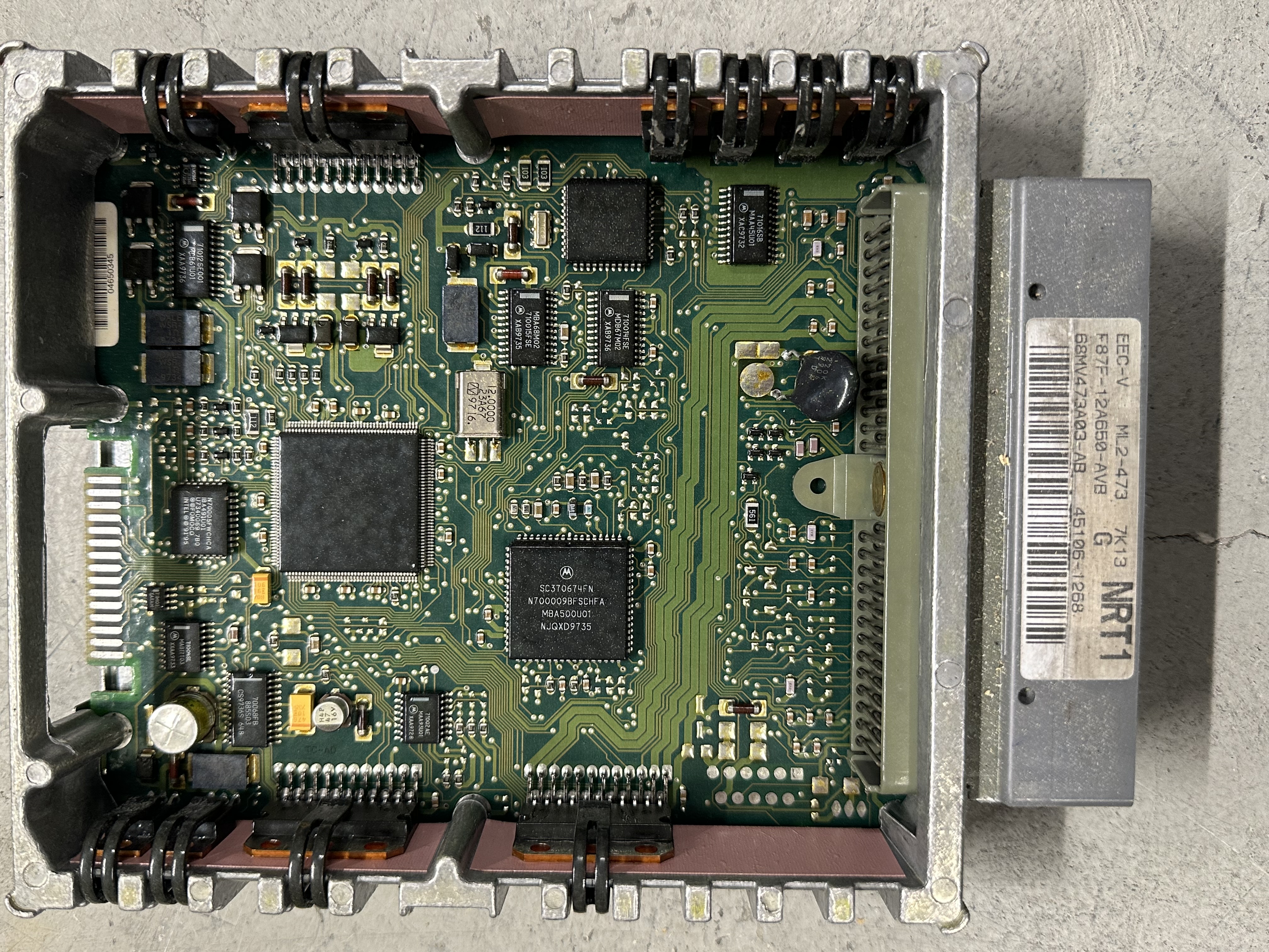

I have several PCMs sitting in my garage at home. Random as they may be I will open them up this weekend and try and get pictures for you.

Here are a few. I have a few more that I’ll post up in a bit.

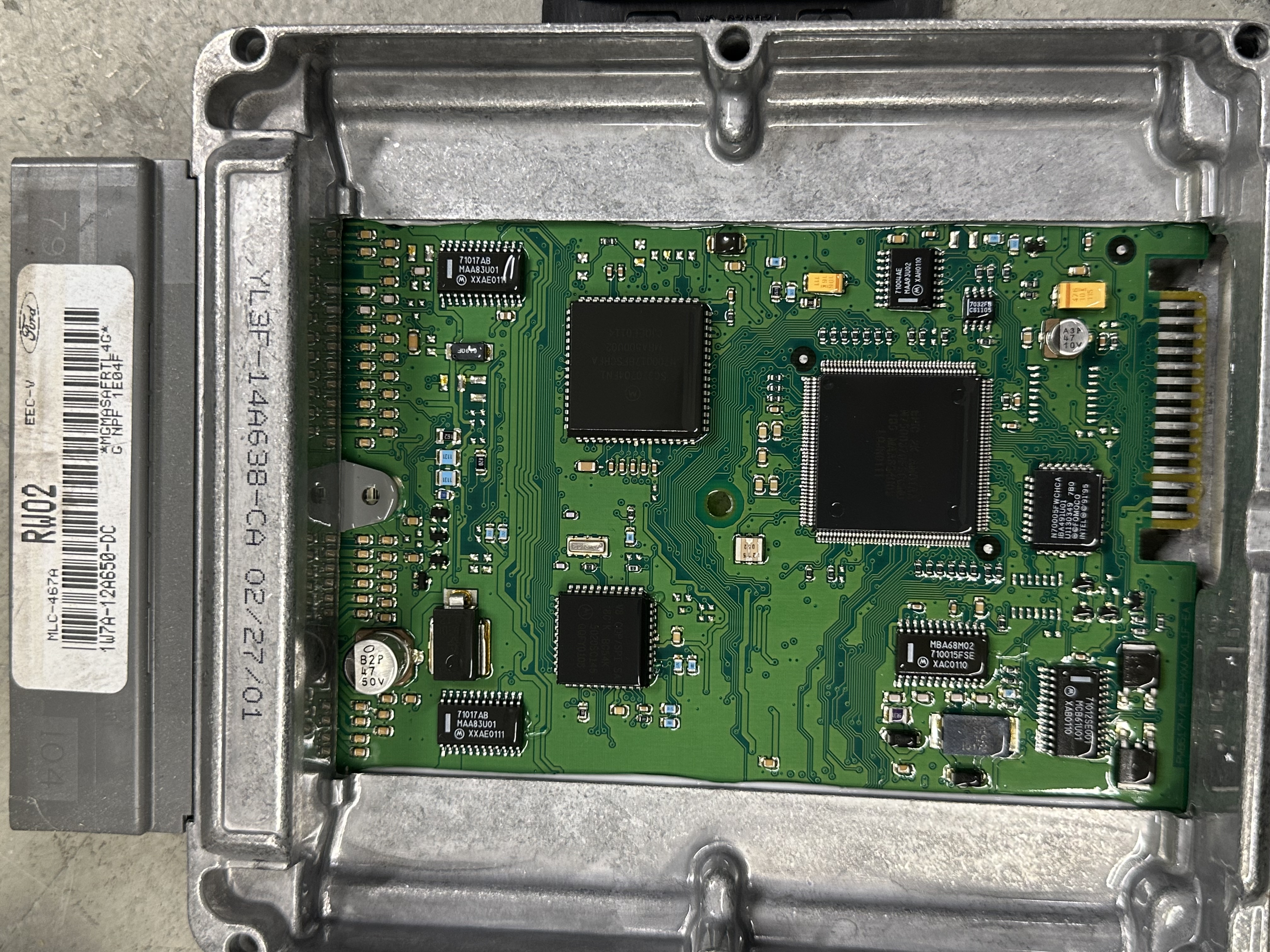

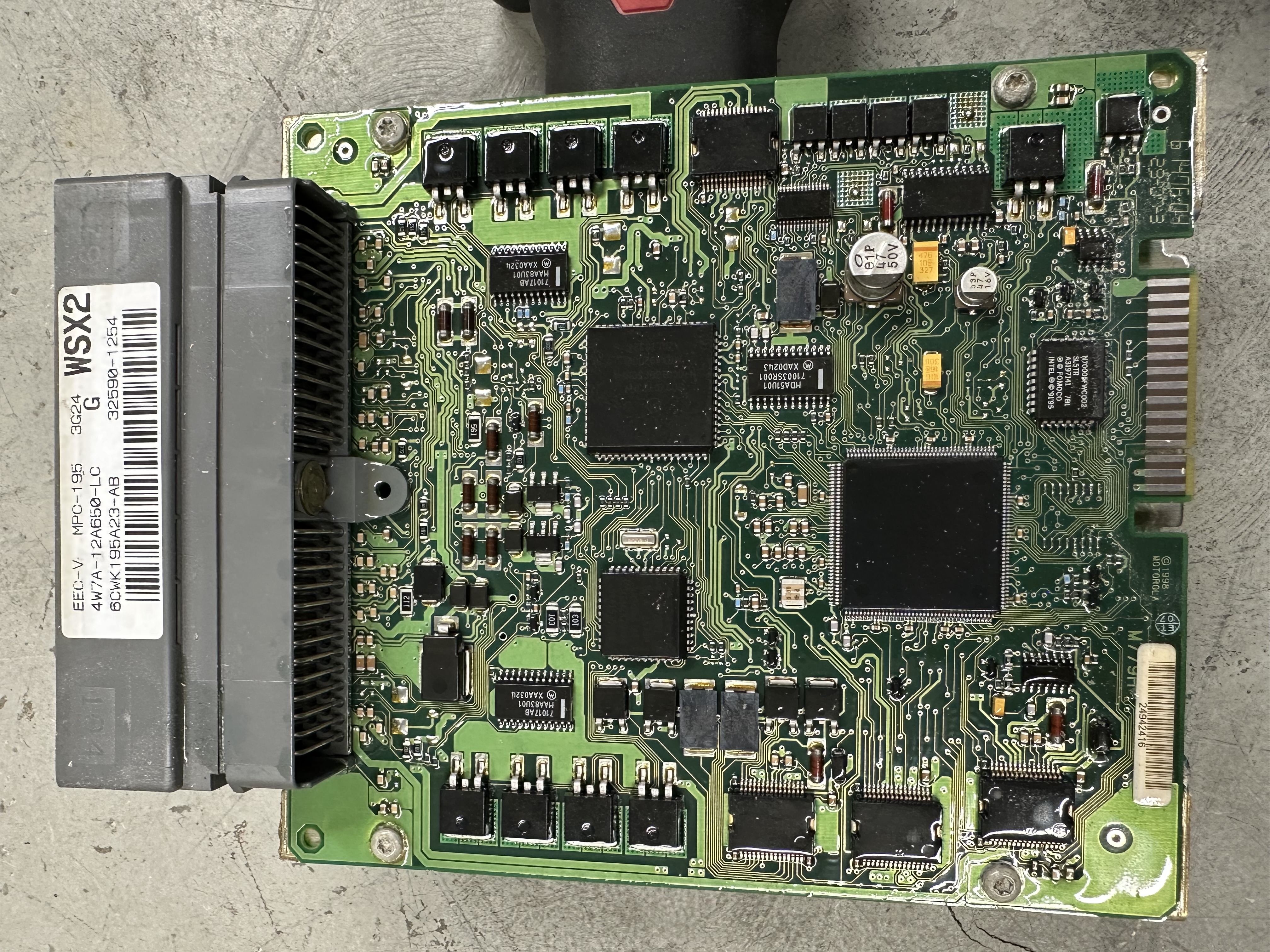

And the rest. Let me know if you need close ups of anything.
