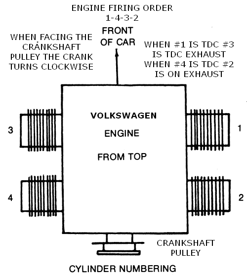

Yes, an inline 4 cylinder engine doesn't have banks but the layout of a boxer engine has 2 cylinders on the right side and 2 cylinders on the left. They do resemble banks as in a 'V' or 'W' configuration.
I have read instructions for arranging the spark/coil wires that would be used with wasted spark utilizing the EIDS module on the VW 4-cylinder boxer engine so I understand how rearranging the pins could create a new firing order that the ECU would not know about.
I have an article about rearranging the pins to effectively change the firing order if you are using an ECU that was originally used on a Ford HO V-8 and the concern there is the readings of the Heated Oxygen Sensors on the right versus the left bank where the pins from the normal V-8 firing order were rearranged and the statement was that doing this will create a cascading effect of lowering the fuel to the cylinders with the rearranged pins. There is no explanation how this can occur, though.

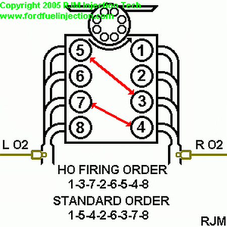

Here is the link to the argument for not changing the pins. I am not saying you are wrong but if you haven't seen this you might find it interesting. This addresses a V-8 engine configuration. In my case if I used only one HEGO where the exhaust from all cylinders comes together maybe I will not have this problem.
http://www.grandmarq.net/oldfuelinjection/page92.html
How about I cut and paste it here.
"Injector Firing Order
There are 2 ways to "correctly" fix a computers' mismatched firing order:
1. The best option is to change to a HO camshaft to match the computer. (not applicable)
2. Or you can reprogram the computer to match the cam firing order. (reprogramming with a chip)
"Firing order does not effect spark at the plugs because that is still determined by what order you put the plug wires on the distributor cap. But if you have a sequential fire fuel injection computer, then the computer program opens the injectors in the same order as the camshaft timing. This can cause issues when running a “High-Output” computer with an older camshaft. If you leave the injectors in the HO order you might notice a slight effect on idle quality. There are no effects once the engine speed picks up because the injectors open so fast."
"Other people with mismatched computers swap the injector pins at the computer plug. This causes more problems than it solves."
"An example of how the computer deals with mixed up injectors:
1. The R O2 sensor sends a rich signal to the computer.
2. The computer will then shorten the pulse width to Right side of the engine. But two of those injectors have been MOVED to the Left side of the engine!
3. Because 2 of the injectors that have been directed to minimize the injector pulse are now on the other side of the engine, this causes the left side of the engine to run lean.
4. So now the L O2 will send the lean signal to the computer.
5. The computer will then lengthen the pulse width to Left side of the engine. But two of those injectors have been MOVED to the Right side of the engine!
6. So now the R O2 sends another rich signal to the computer.
7. Cycle repeats, each time getting worse."
"You end up with 1, 2, 5 & 7 running 25% rich, and 3, 4, 6 & 8 running 25% lean!
Therefore it is strongly discouraged to mix around the fuel injectors." (See V-8 GIF illustration)
The VW firing order is 1-4-3-2 and the Ford is 1-3-4-2. Would it be better to move the pins around or modify the programming? Will I still need a cam timing device for the sequential injection? There are ones available for the VW. I am checking on a vehicle speed sensor. I may adapt one from an ABS equipped vehicle and put it on one of the transmission drive shafts constant velocity joints at the transmission. Please supply advise.

An eec-iv is perfectly fine for your application. The main issue is the finding DIY tuning hardware (now Moates have closed) and a definition to suit the strategy your ECU uses. For the latter it is best to find what strategies are supported and then select an ECU that uses one of those.
The different firing order of the VW and the Ford engines is not a problem, just rearrange the injectors and HT leads to suit.

The two VW FI suppliers I know about that are in America both had cam position synchronizers but neither is offering any now. I purchased a new manufactured distributor for @$30 that I am going to use to make a cam position device using the same kind of sensor that is used with most of the crankshaft sensors. The Dub Shop uses a VSS Hall effect sensor (Ford Probe or Mazda Miata) that is very short and I am going to use the same type in the body of the new distributor and a single tooth over the distributor cam (starting with a multiple tooth reluctor). This will produce a signal that the EEC-IV can use. The signal should be identical to the sensor used on the 1.9L engine.
Will I get the same signal for the cam position if I use a magnetic pickup?
Thanks for your insights
Paul Villforth
