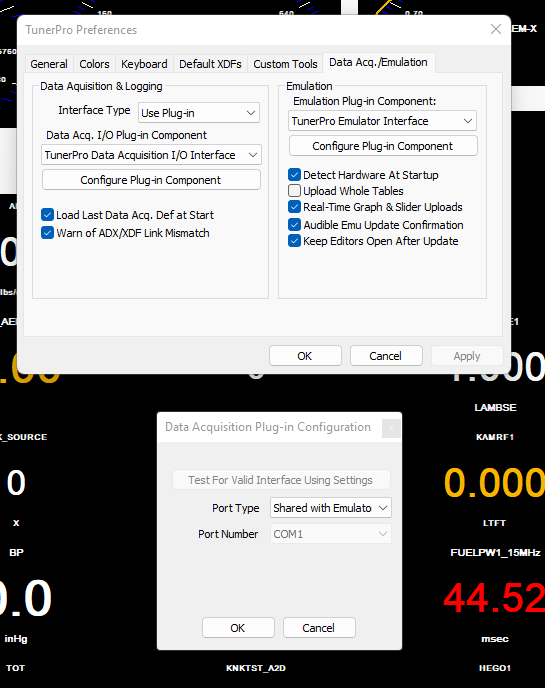

In preferences make the data acquisition tab look like this:
Turning on tracing requires that you select the data types for each desired parameter in the xdf. It takes a bit of time but it's easy work. There's a nice guide out there if you Google for it. Michael does not select them since he doesn't use data to tracing normally.
