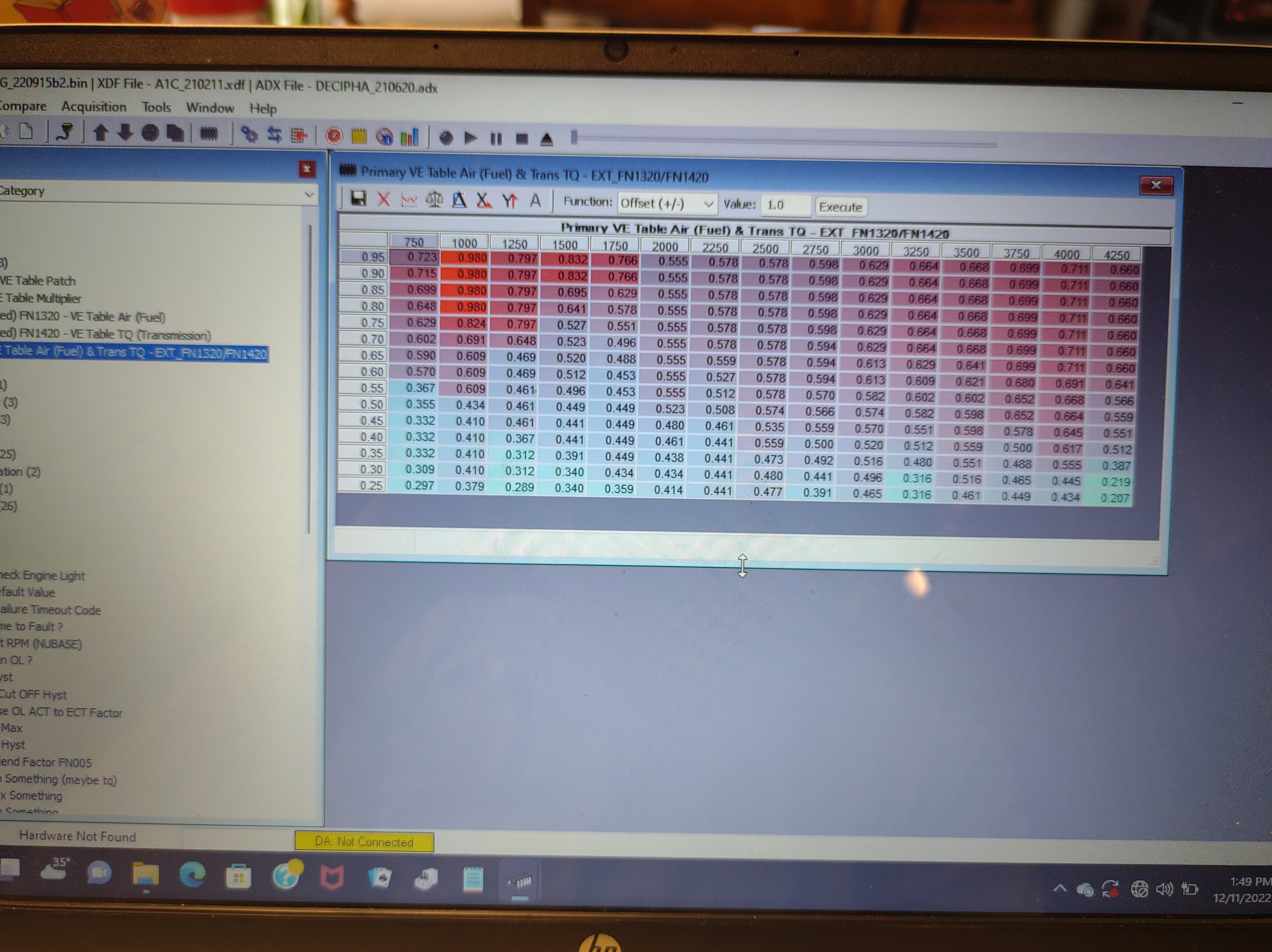

No, the surge is gone once it settles. It runs the same with our without the IAC plugged, which tells me I could probably close the throttle stop a little more. Now it just does weird things like goes offscale lean as it approaches idle from decel and then takes a few seconds of running like garbage before ISC steps in to fix it. Also, coming out of idle it will sometimes go so rich it almost stalls. I think this is because the 1000-rpm / high-load cells in the VE table are massively rich, but I'm hesitant to start changing things until I understand what I'm doing.
Here's a screen shot of the VE table. Obviously it needs some work in the idle region.

I started messing with the VE table. It appears that's the source of all, or at least most, of my woes. I pulled almost 40% out of the 750-1250 rpm / 60%+ cells and that got rid of the stumbling rich fall-on-its-face routine if you bogged it letting the clutch out. I then started running logs and using the histogram to tweak the VE table. It appears that works good for the "meat" of the table, but not the fringes - gotta spend enough time in a cell to get a good averaged correction factor. The other thing I found was if I made the 25/30/35% load cells as lean as the histogram called for, I got nasty trailer hitching when trying to feather in and out of the throttle. So next step is richen those up to make it drive smoother. Fingers crossed that after a few more sessions experimenting with the VE table, I'll have rid it of 95% of the weird behavior. After that I can worry about ISC parameters, transient fuel, etc. As a final step I'd like to set up open loop enrichment for WOT.

Re: Idle stability control in A1C
