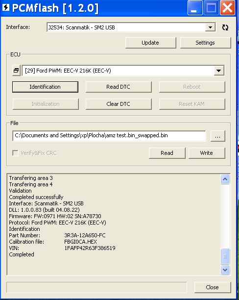

Hello. I tried write zYA2 into my mach1. After write complete(pcm flash), fuel pump ticking with ignition on. I tried identicication button in my pcm flash, pcm flash display error on vin and strategy, immo light on, radiator fan activate with ignition on, sym2 same problem but AMZ_stock, MGZT_stock works without problem. I only insert vin and pats code into all bins.I was not tried start car...
Attached picture from amz2 write...on zya2 is ERROR status at strategy and vin location...

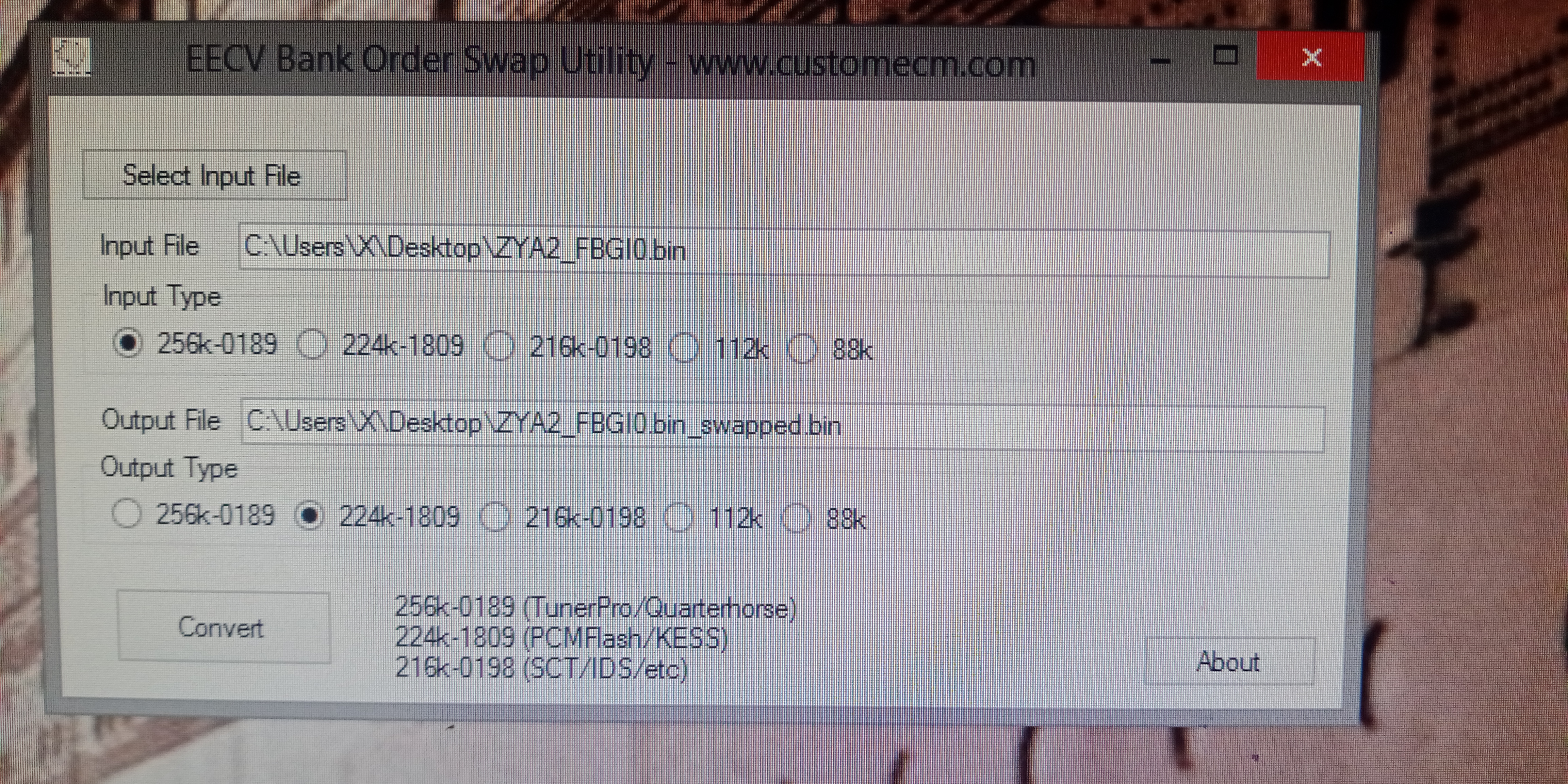

256k bin open in tuner pro, insert vin amd pats after closed tuner pro was convrted to 224...with amz2 works

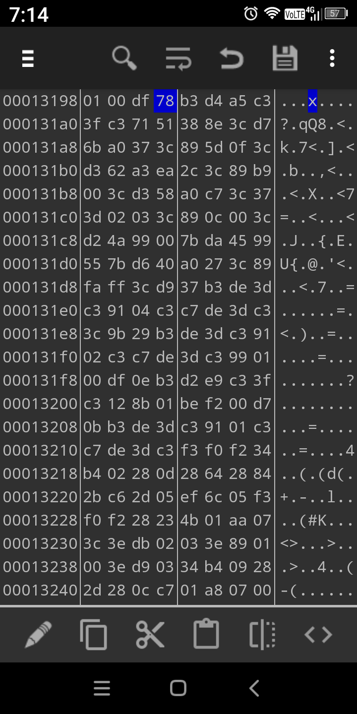

Re: ZYA2 not work?
the code at 1319b is all corrupted

Are you using tool from custom ecm solutions to swap the banks?

Yes. Picture attached higher.

decipha wrote: ↑2022 Dec 05, 19:00 the code at 1319b is all corrupted
Wrongly converted to 224?
How I can fix it?
78?
Posts: 7112
Re: ZYA2 not work?
your missing a ton of code. You have to put the missing code back in.
