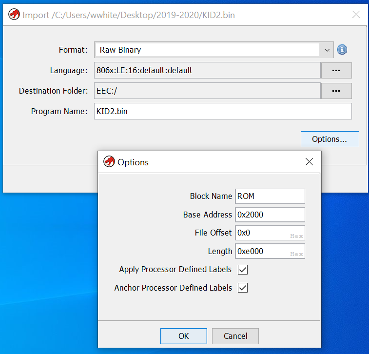

And here are some images to get started after the processor is installed in Ghidra:
1. Create a new project, name it EEC or similar
2. Import your binary
3. Select the language
4. Enter options, hex start address 0x2000, give it a name, ROM
If you make changes to the processor files, you must re-compile them, using:
./support/sleigh -u -n -a Ghidra/Processors/806x/
Also, you must restart Ghidra to pick up the changes.
