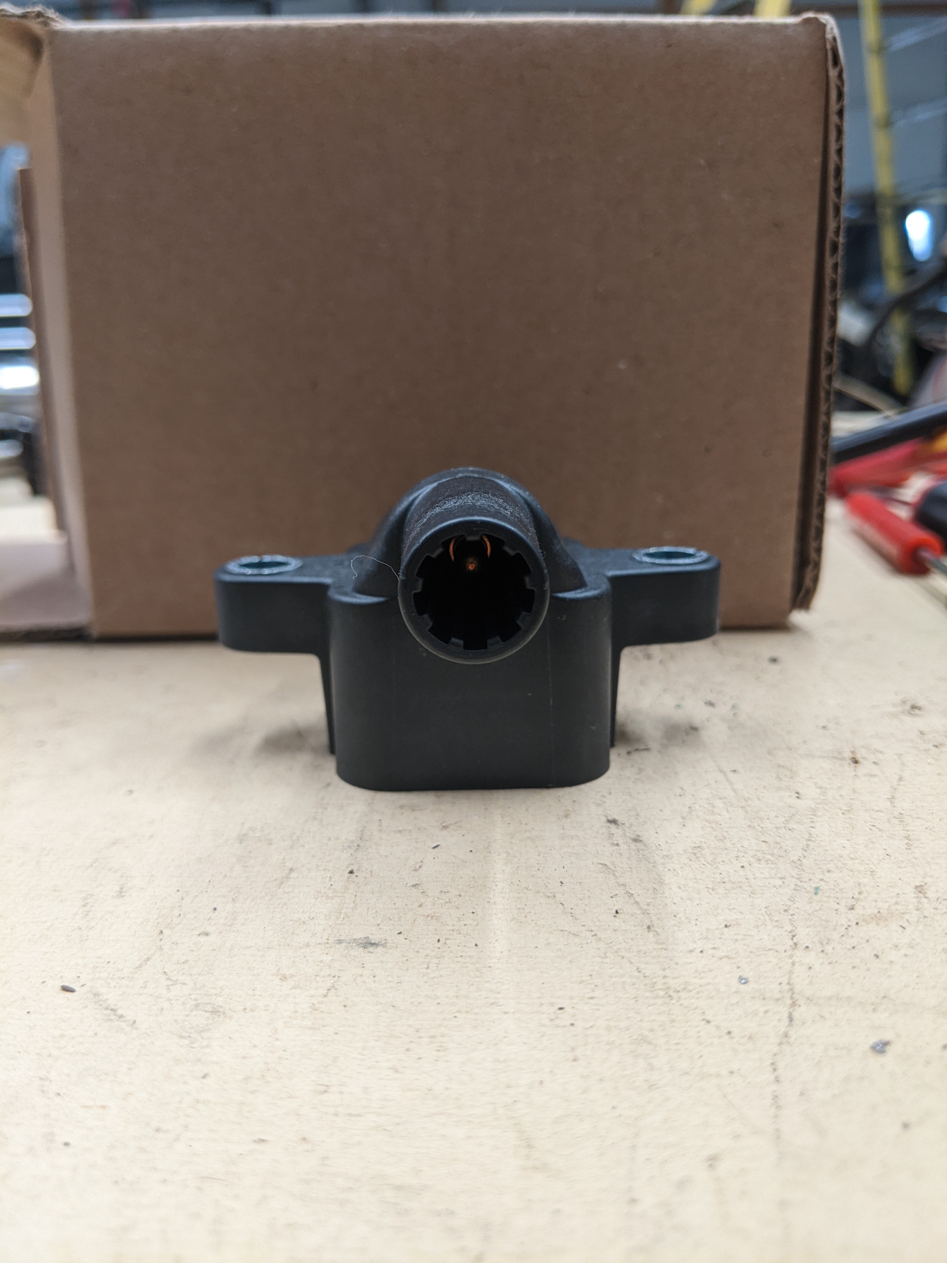

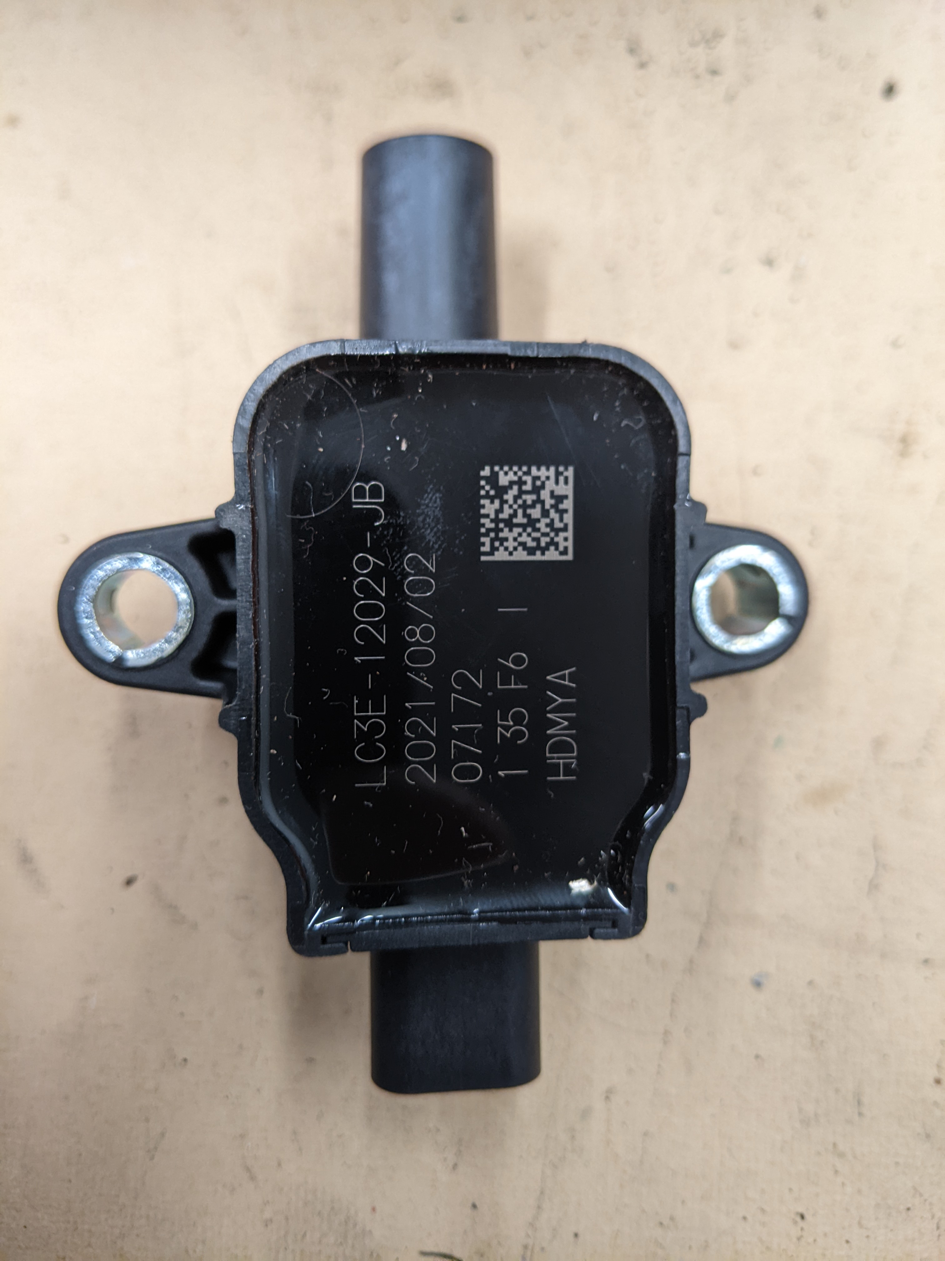

I just ordered a coil from the new 7.3L godzilla engine to see how it fits. From pictures it looks to be a 2 pin, so shouldn't have a built-in ignitor.
https://www.rockauto.com/en/moreinfo.ph ... 0&jsn=1010
We'll see....

Unread post by RinerAuto »
2020 7.3L coil was delivered today. Two pin connector. Don't think it will work with LS wires, but can get the ones for the 7.3L too. Would also need the electrical connector as it's different from the 4.6L stuff.
