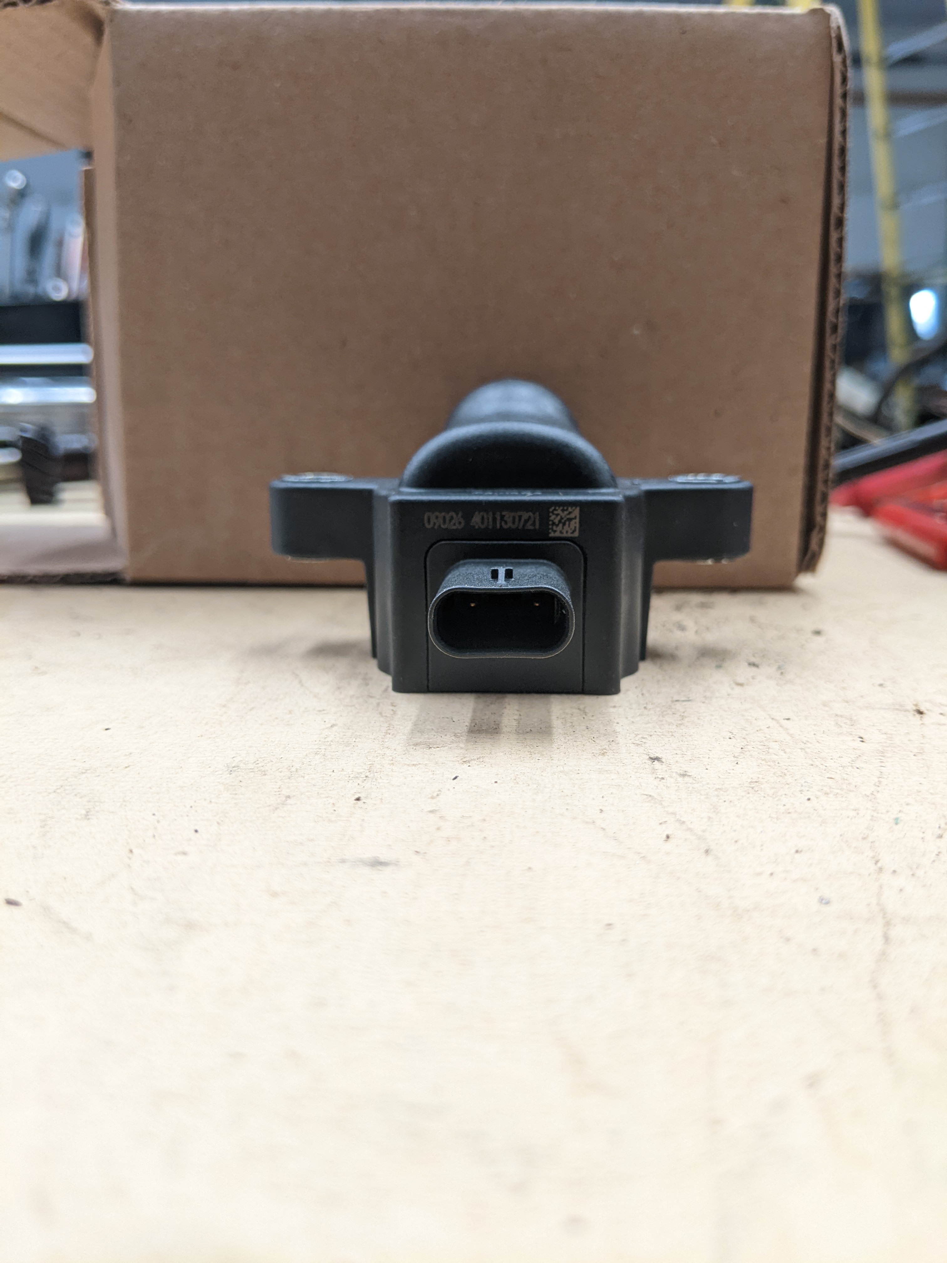

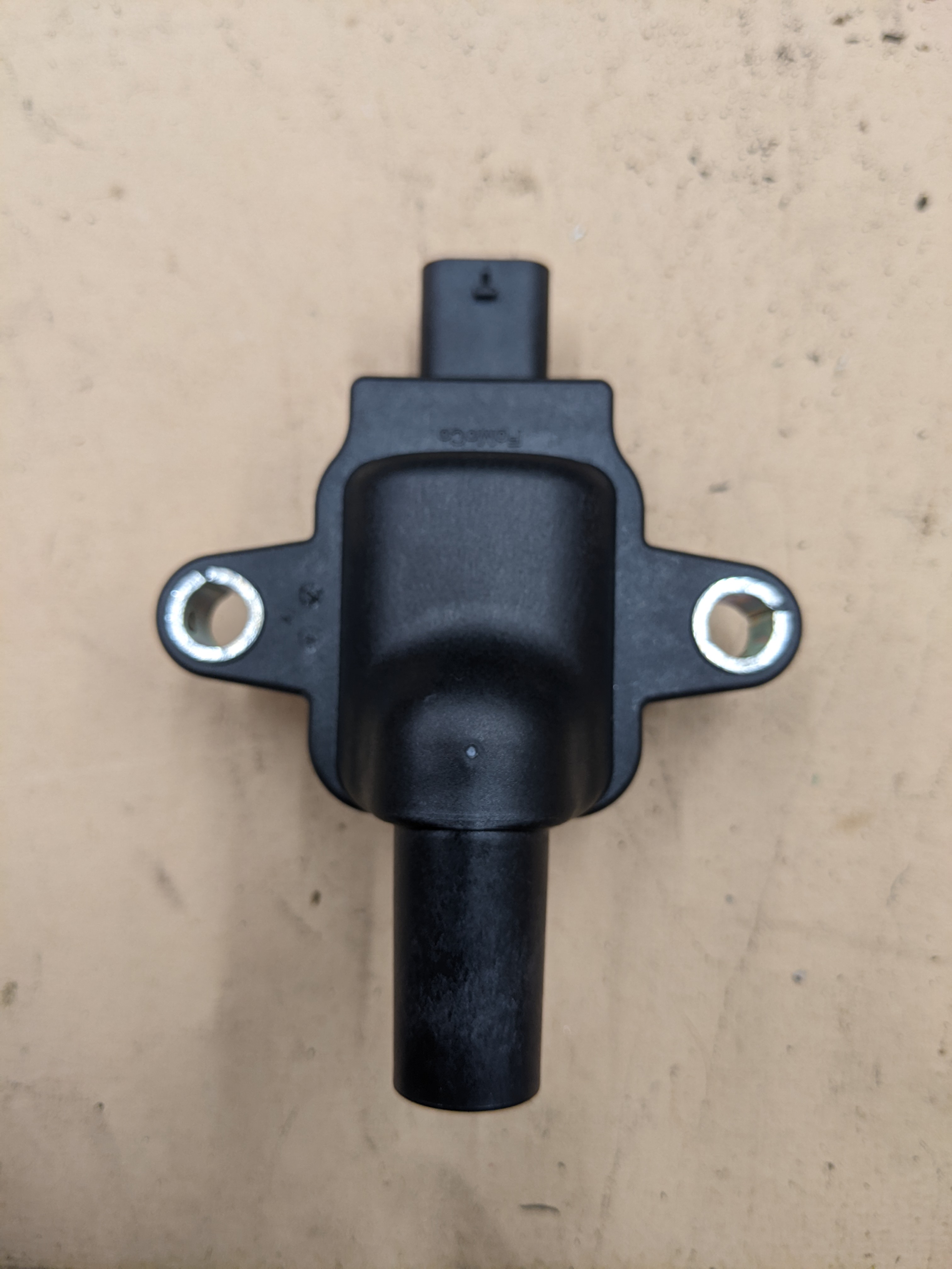

I just ordered a coil from the new 7.3L godzilla engine to see how it fits. From pictures it looks to be a 2 pin, so shouldn't have a built-in ignitor.
https://www.rockauto.com/en/moreinfo.ph ... 0&jsn=1010
We'll see....
We'll see....
- Posts: 100
- Joined: 2021 Apr 14, 15:30
302W w/RZASA and CNP
YouTube: RinerAutomotive
Instagram: RinerAutomotive
Re: Which LS plug wires
2020 7.3L coil was delivered today. Two pin connector. Don't think it will work with LS wires, but can get the ones for the 7.3L too. Would also need the electrical connector as it's different from the 4.6L stuff.
