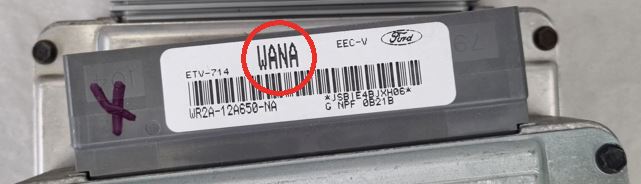

Hardware code is MPC-204, where can I find my Cal Code?

What's your catch code? In my case on the FBFG2 strategy, it's PTP2, it'll be on the tag on the PCM.
