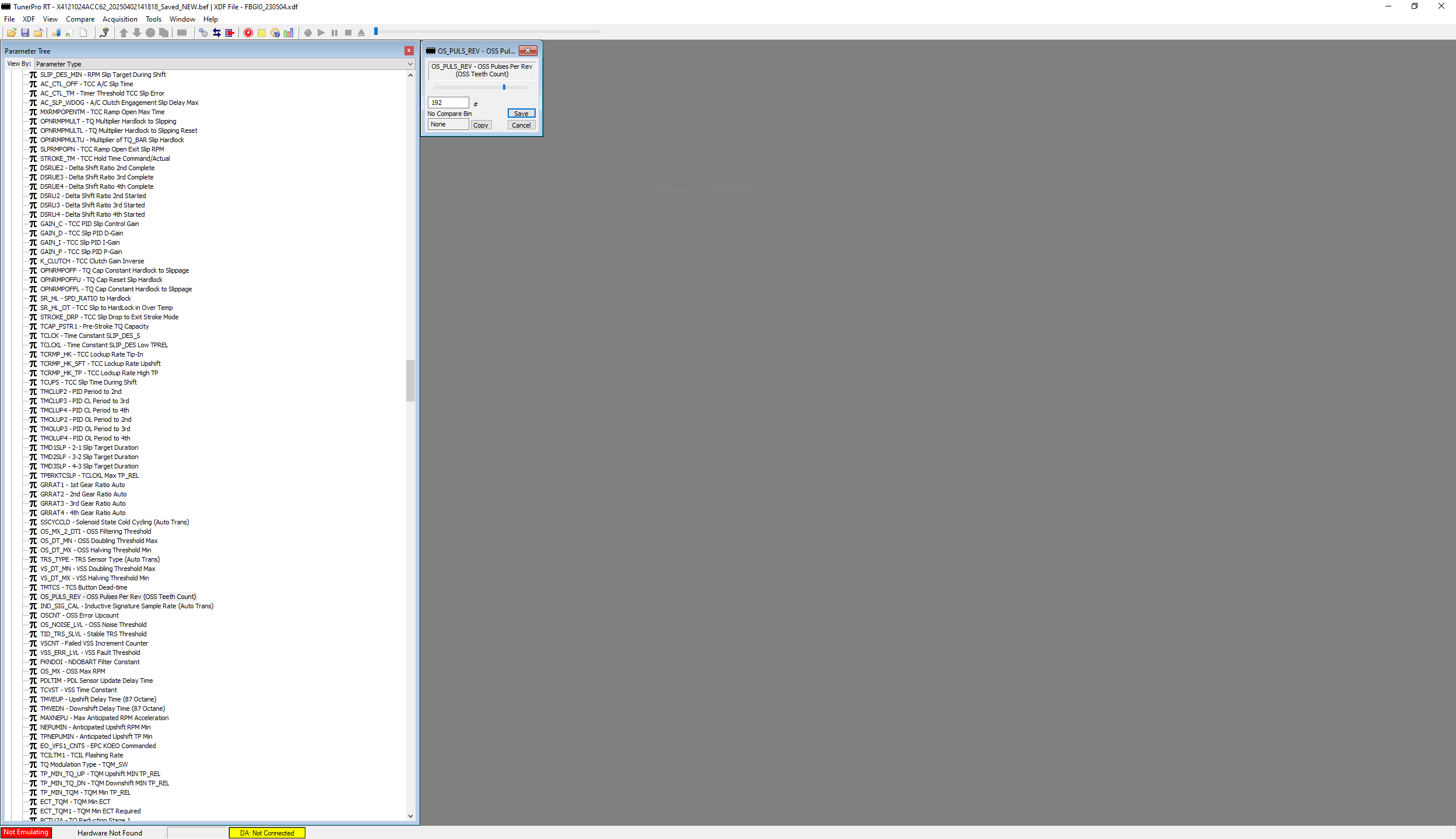

I am new to tuning and am having some trouble with fixing the Output Speed Sensor Pulses Per Rev. The tune I pulled off of the truck seems to not like the XDF file, wondering if anyone had any suggestions or any help they could throw my way.
I am using an SCT X4 to retrieve the tune on the truck and plan to install it using that, I'm not sure if that could cause any issues, but seemed to me to be the best option. When I retrieve the file back on my PC, it shows as a BEF file, and not a bin, so that could be the issue, just not sure how to make adjustments to that.
