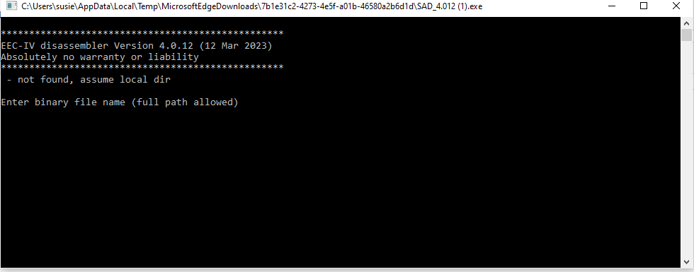

Here is what I see after opening SAD

ATPCR wrote: ↑2023 Oct 08, 07:57 Here is what I see after opening SAD
Type in the bin pathname and filename then hit enter.
If you have sad and the bin in the same folder then just type in the filename then hit enter.
Drag and drop is easier.
