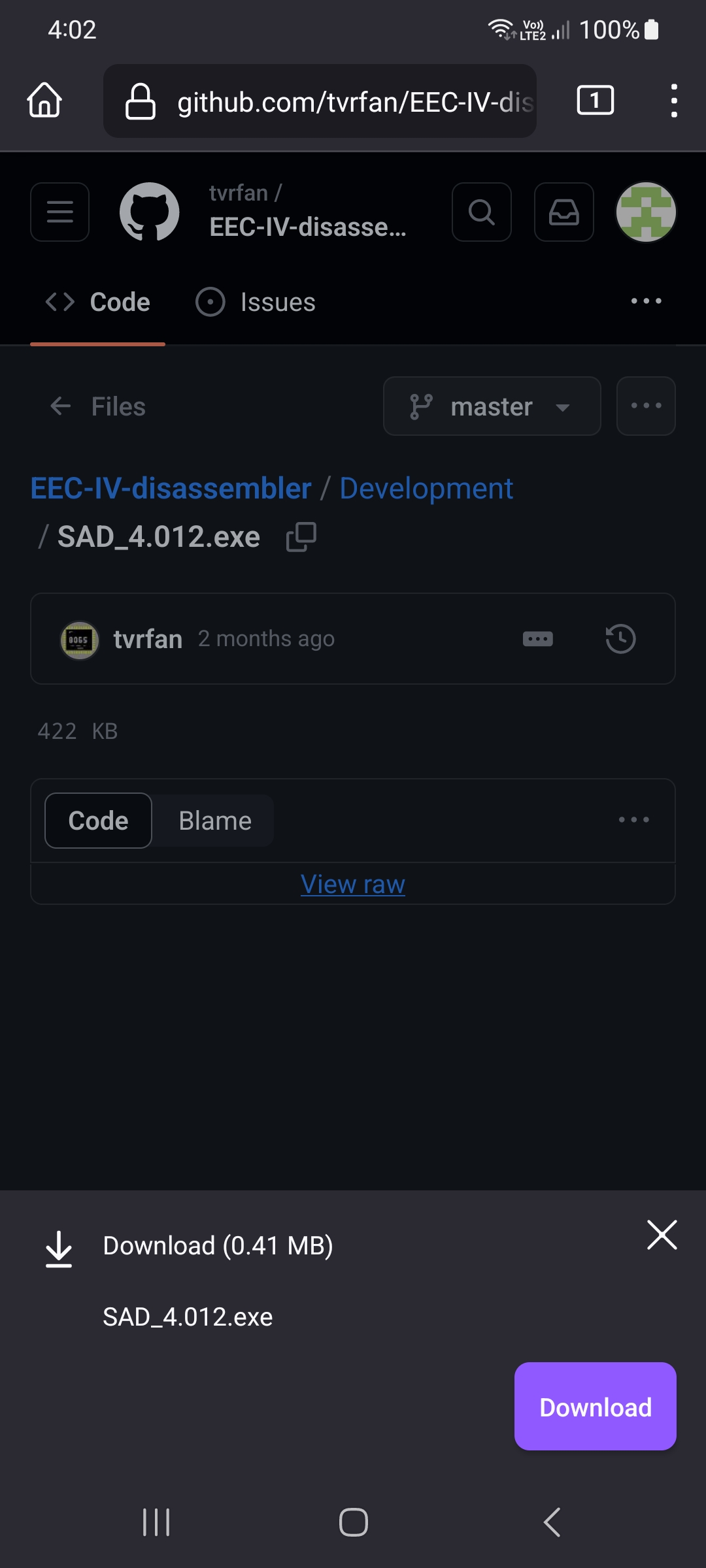

@jsa is this a downloadable tool? https://github.com/tvrfan/EEC-IV-disas ... _4.012.exe and where is the download button?
Posts: 450
Re: EEC V file conversion
Click on View raw to start the download.
