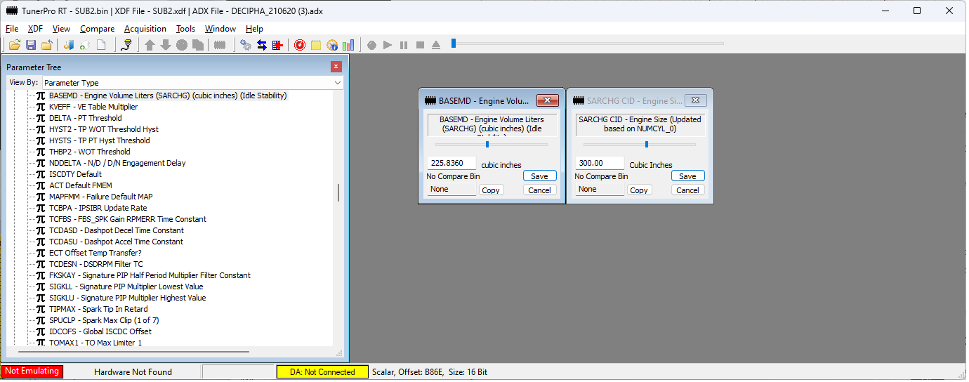

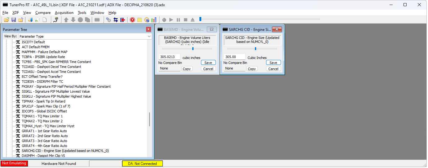

As I noted in J1X the setup for the 4.9 does not use actual engine size for basemd:
(225/6) * 8 = 300
Could this have something to do with the isc weirdness in A1C? I believe changing basemd requires re-tuning the ve table.
(225/6) * 8 = 300

As to basemd, I believe Michael had that set to the 225 c.i. value Ford used for the 4.9L in the earlier tunes and it had the same idle issues. His notes do say that basemd is for idle stability. Then again all his instructions were written for mass air strats, so we're in a kind of alternate reality with the speed density stuff. All that said, I really wasn't having what I would describe as idle stability issues. Once it switched to closed loop idle control, it stayed there. The problem was a weird timer thing where it would pull all fuel and sputter upon closing the throttle for about 5 second before going into closed loop idle control and stabilizing at stoich. That and the reported ISCDC value making huge swings without actually affecting idle. That part really seemed like an addressing issue.

Re: SUB2 stock bin - '95 4.9L E4OD
The total air mass flow into the engine (AMPEM) is computed from the basic equation:
Mass = Pressure * Volume / (Gas Law Constant * Temperature in Rankine)
Because the pressure can not be directly computed it is inferred from engine speed and manifold absolute pressure and a table of volumetric efficiency a a function of engine speed and load.
BASEMD must be calibrated to provide the engine volume for this calculation as well as the Gas Law Constant.
BASEMD = 0.0234393 * Engine Displacement in Liters (lbm - deg R/in. Hg - rev).
SARCHG = Standard Aircharge = 4.4256E-05 * CID / of cylinders.
