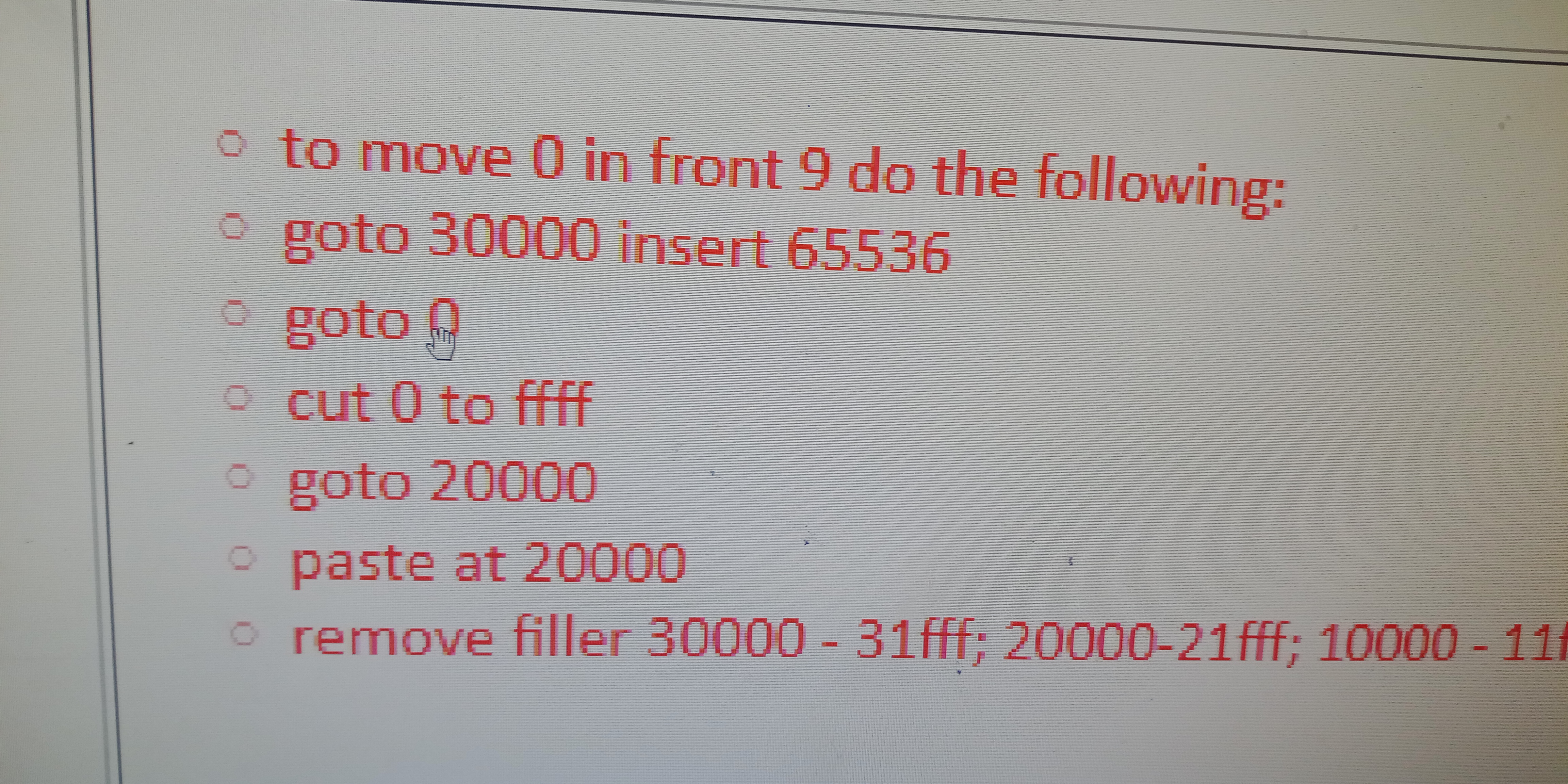

Ok. Thanks much. I tried convert amz2 for cobra and no error after write...only with zya2...I will convert manually but dont understand whats mean insert 65536 look attachment

65536 bytes or 0x1000 bytes
