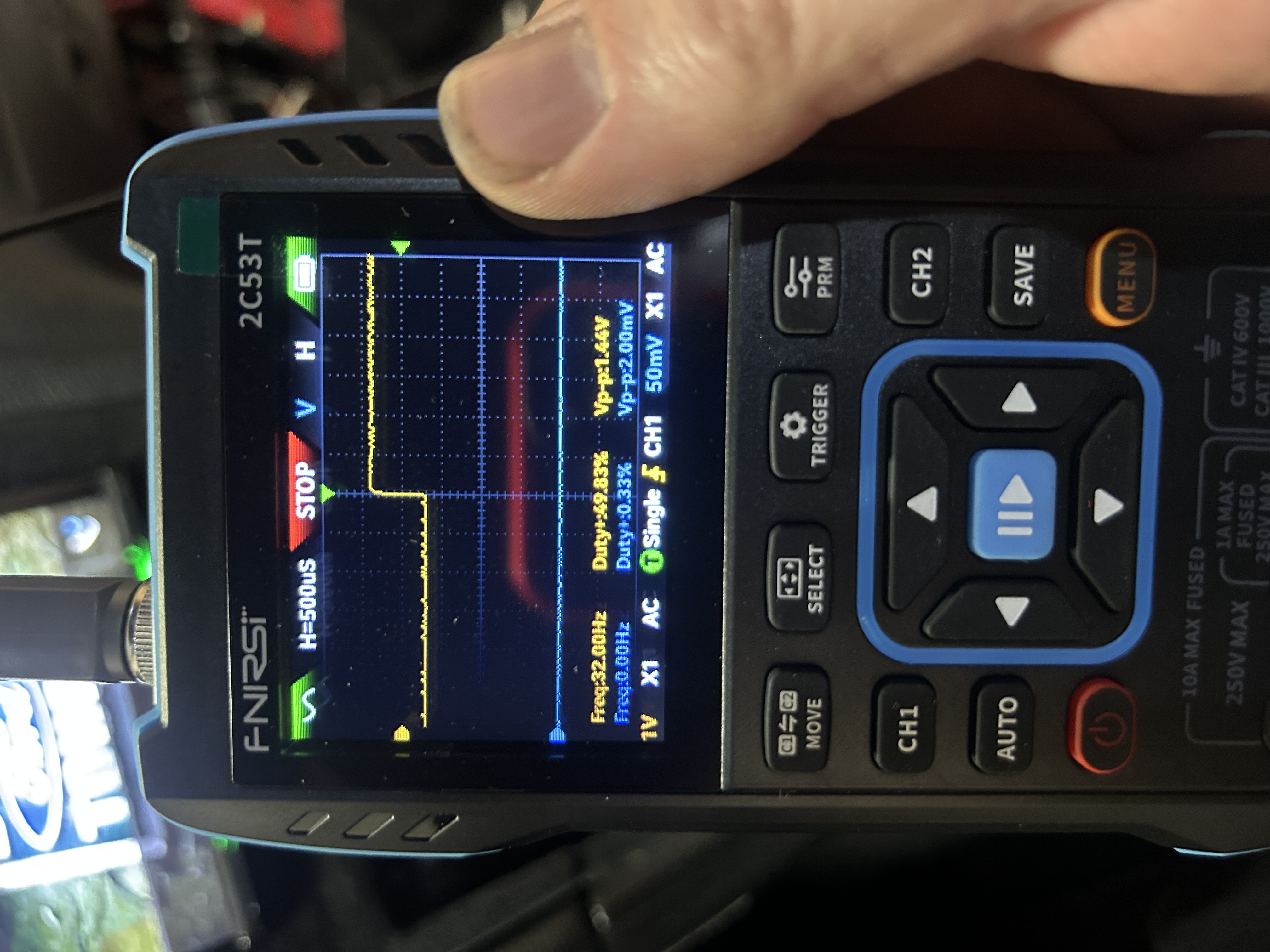

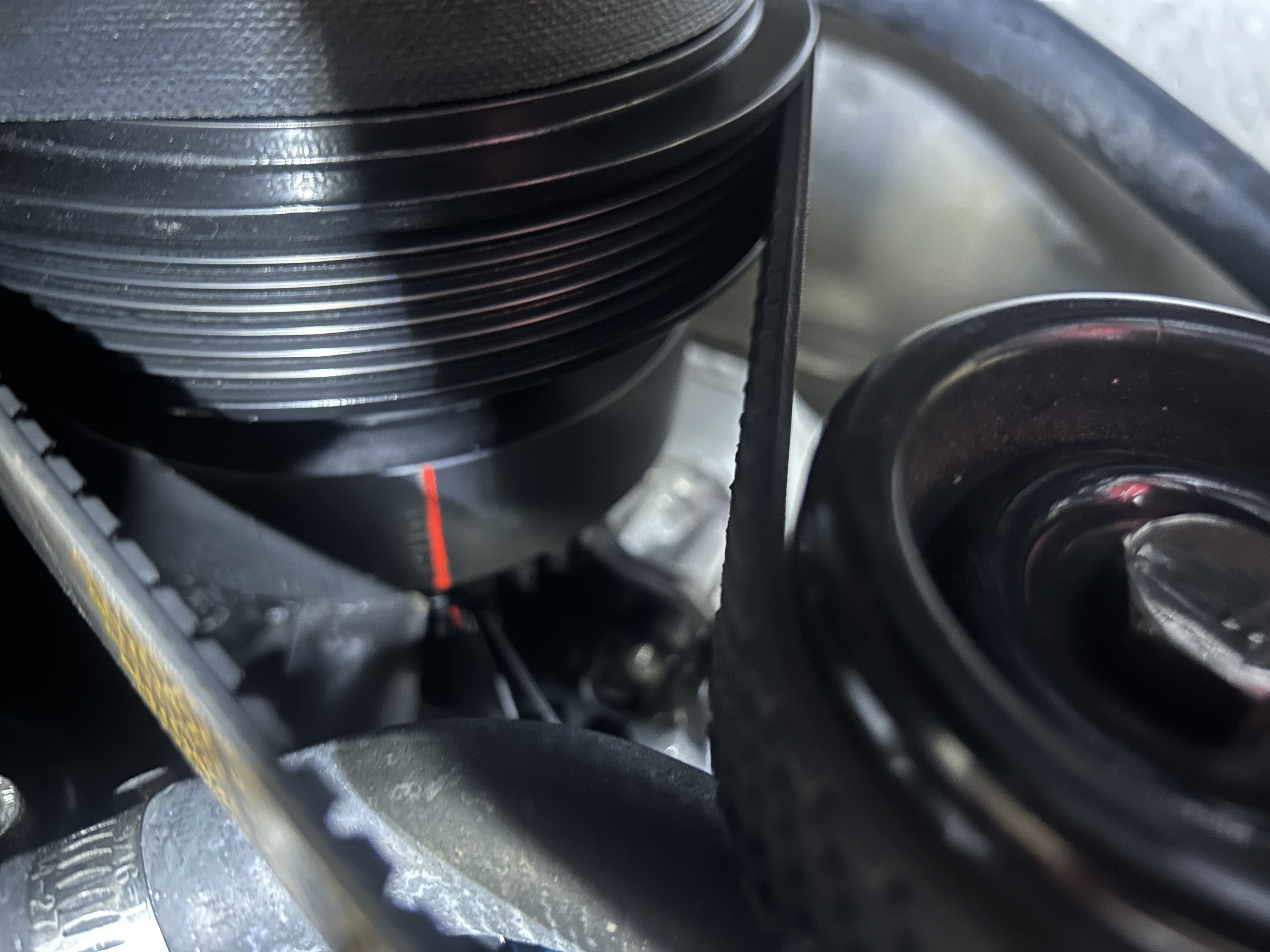

scoped cam signal at ECU and it looked great with low noise. Pulled #1 plug on compression and confirmed TDC matches TDC on dampener. Mover ATDC to the mark I made going off the OEM dampener and checked alignment and the tool fell right on. Now no MIL, will keep and eye on this

For the amount of power your engine is making (42% more than stock n/a per cylinder) it sure does not want anywhere near the amount of transient fuel most engine would that are making ~33hp per cylinder.
Odd, in any case I cut it back significantly. Hopefully it tames it a bit.
The cam is still not syncing, the red sync_fail on the dashboard is to let you know its batch firing. It won't set a fault or a check engine light for the cam not syncing only if the cam sensor fails.
Are you sure the engine is at 26 degrees and the inverted U is at the middle of the tang on the cam sensor ?
In any case you can't begin tuning it until you get the cam sync'd otherwise your fueling is going to be inconsistent.
