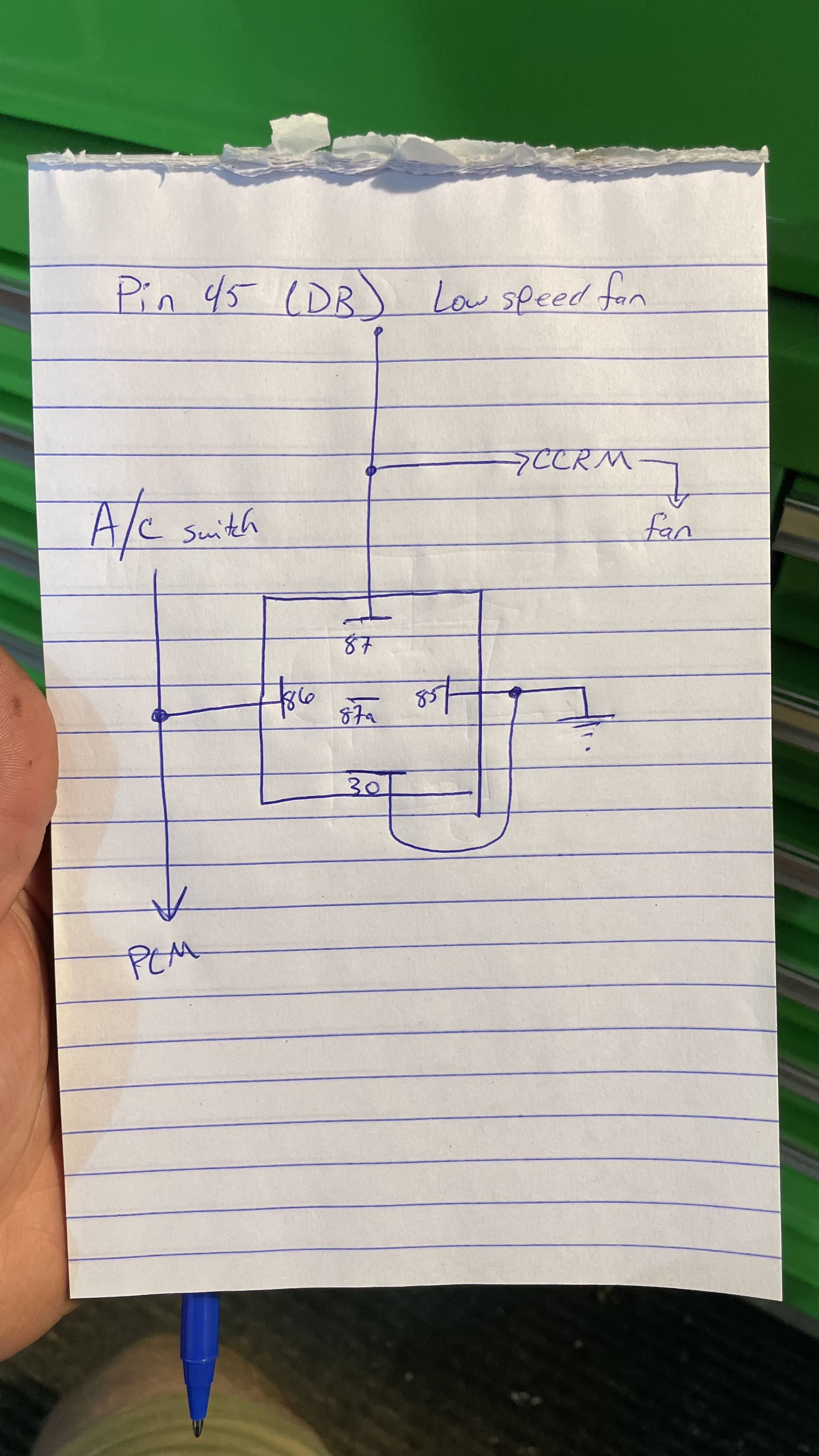

Weird. I’ll do some digging with it later tonight and if nothing else, I figured I’d wire up something like this…
