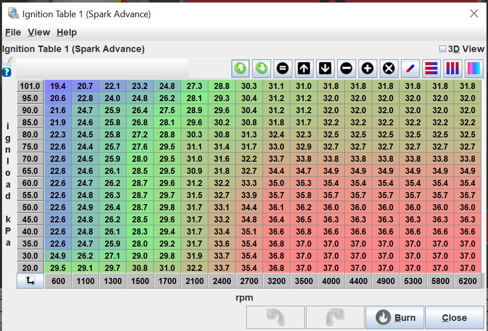

I am working on building out my base Ignition table for my MS3 powered Mustang. Based on your writeup (28 MBT, 36 Cruise) I might be too aggressive on my table. I'd appreciate your opinion.
Shooting for an 800 rpm Idle.
Current Ign Table
Current Ign Table

i would add 8 degrees from 45 on down
95 subtract 4, copy that to 105 and then blend everything between

Thank you sir, Ill see how that works out
