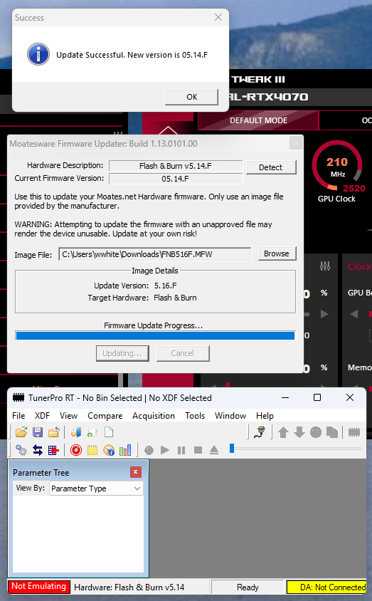

Well, now I'm just pissed.
Downgraded to v.14, and now cannot upgrade. It's stuck at v14!!!
If I use v16 or v18, it successfully says updated to v14.

wwhite wrote: ↑2025 Oct 28, 22:02
decipha wrote: ↑2025 Oct 28, 11:03 You can change the firmware by flashing the jaybird. Prob need to dig around on the moates site to find the specifics and download what you need.
What does TPRT say at bottom left?

Nope and Nope.
Using the firmware updater, select 5.16.F, says its successful with 5.14.F, and TunerPro shows 5.14.F.
don't know, should i contact Moates?
