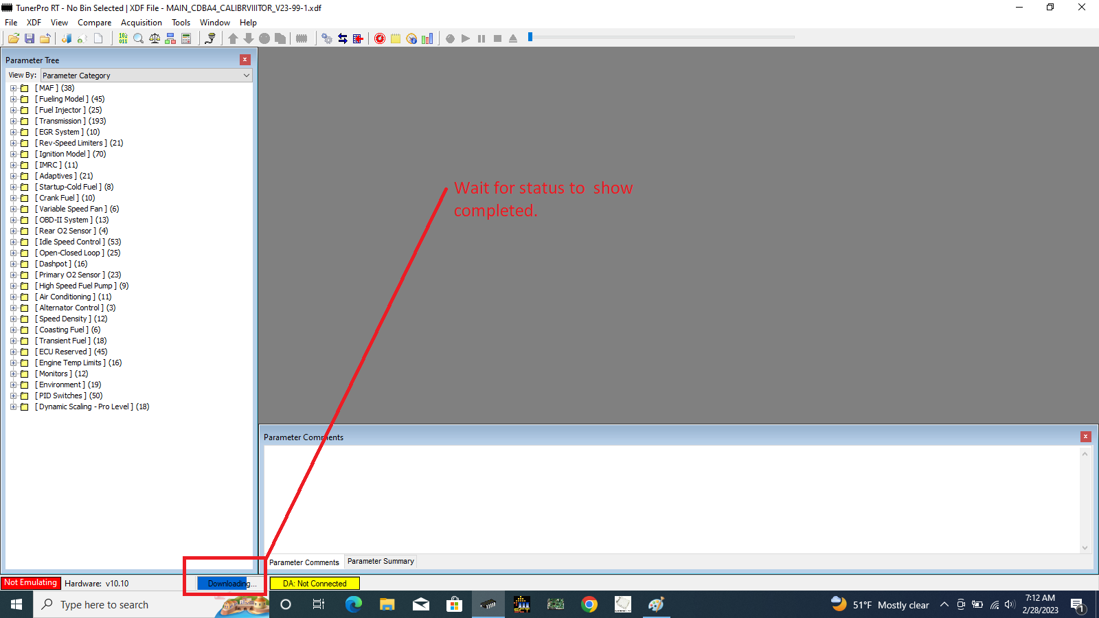

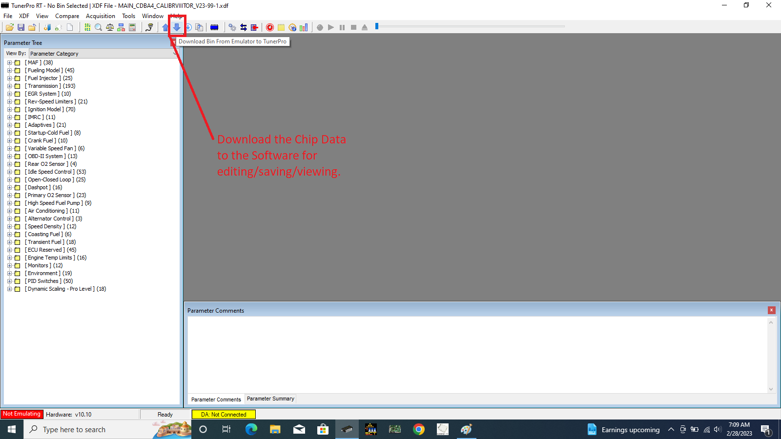

That's my concern.
The Ostrich I/O version 10.10 is what the TIP chip burner uses in TPRT. I can only address offsets when dumping ROM to a file.
When using the upload tune feature, it writes however, when placed on the j3 fuel pump runs constantly.
Only on EEC-IV.

Re: TI Chip, 56k USDM offset/order
yea but, look at the picture as the UI is not F&B, nor does it work with the TIP burner.
I can get the chip to read via Burn2/Chip Adapter/Ribbon Cable combo in F&B, but not write. And... not on the J3 card edge at all.
My point is; the TIP burner must pad the 56k 0x0000 to 0x2000 which is bonkers. When I read the chip in F&B and use the normal 56k offsets, its stacked jumbled up. If I read with a 0x0000 to 0xFFFF chip addressing and 0x0000 to 0x0DFFF buffer it gets a clean read. Using that BIN in the TIP burn process with either offset yields a FAIL mode when on the J3. Because again, you have to write with the TIP burner.
Just odd.. wanted to see if anyone else has this issue. 256k, ZERO issues. 56k, pissing me off.
