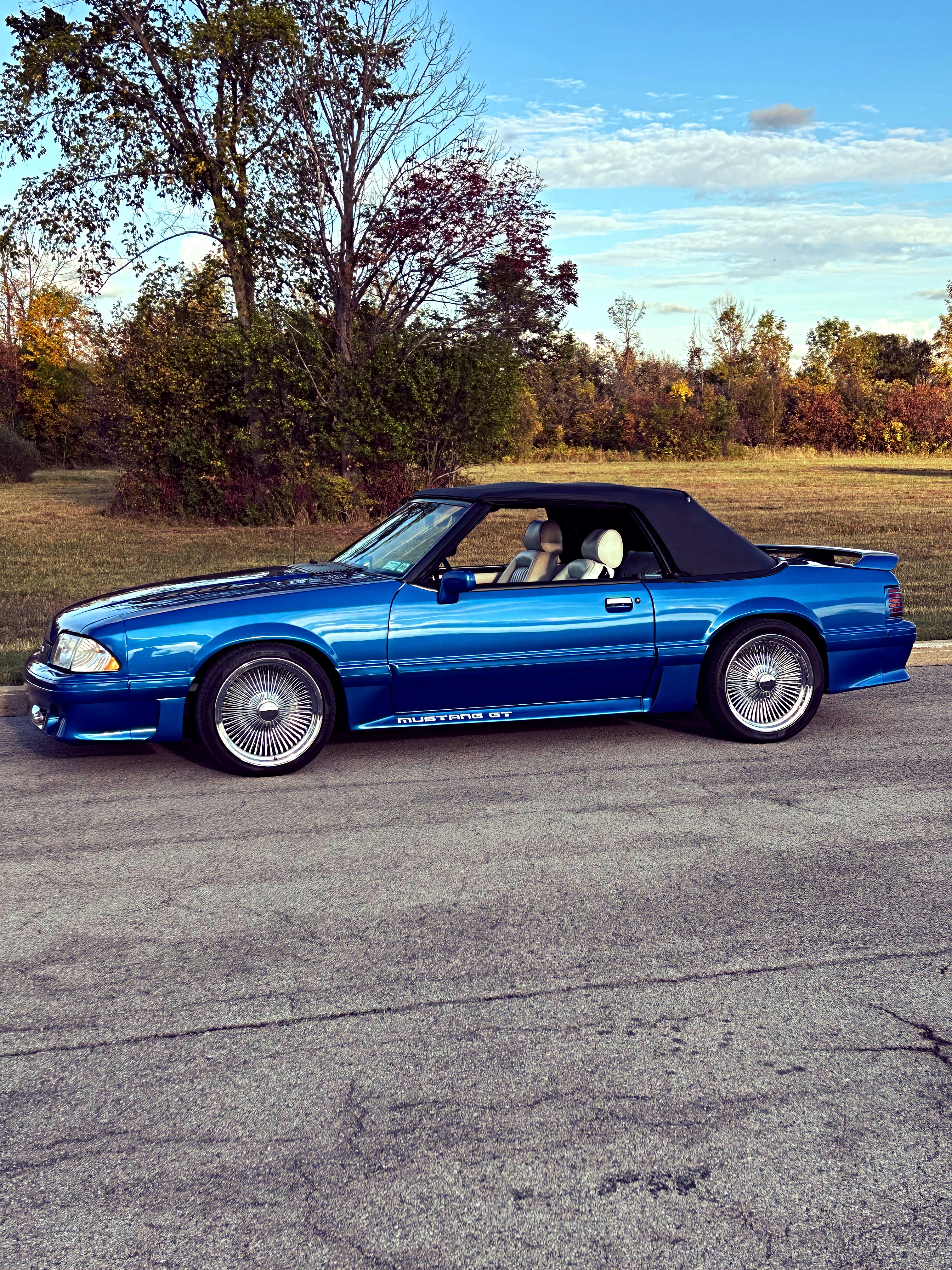

I know pics don’t get posted here alot but here she is
