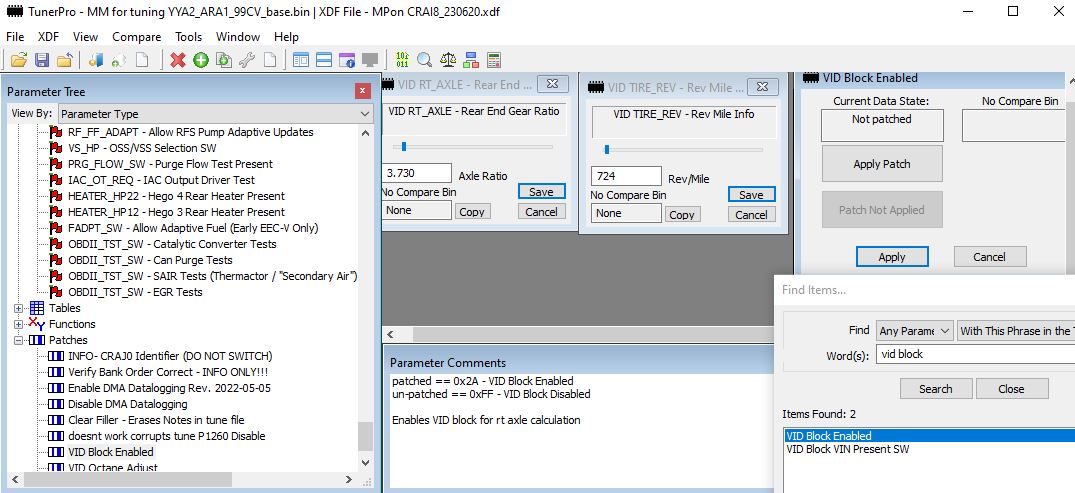

I was trying to set the axle ratio and tire revs per mile but then I saw a note about the VID block. Does it need patched?

you cant edit the vid block and serve it from the qh

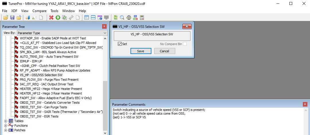

Coils are hanging in there. I went for a drive warmed up in Closed Loop. First, 2nd, 3rd gears shift well. Going into OD, not so well. It kind of bucks and doesn't act and sound right and then I'll let off of the throttle. VSPD on the digital dashboard seems to be reading low compared to the stock
MPH gauge. I found a setting that is wrong for my application. Check out this snip.
Here is a file from a few minutes' drive today that included adding the suggested patch.
