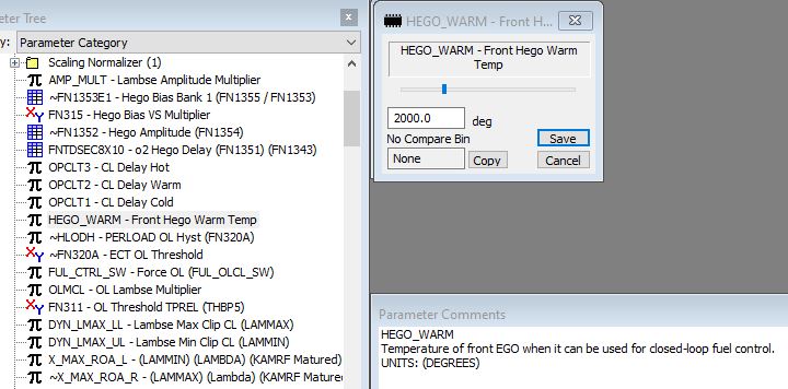

I have a question about the front HEGO warm temp. In the bin file, it is set at 2000F. Shouldn't it be more like 500F ?

CHT and ECT require significantly different hardware and are not interchangeable.
disregard that scalar it has nothing to do with CL.
You posted in the wrong forum, you need to post in the actual strategy your using so theres no mix ups for differences in the various strategies.
CL is entered based on the CL delay scalar or function and after the hegos have switched a minimum amount of times
