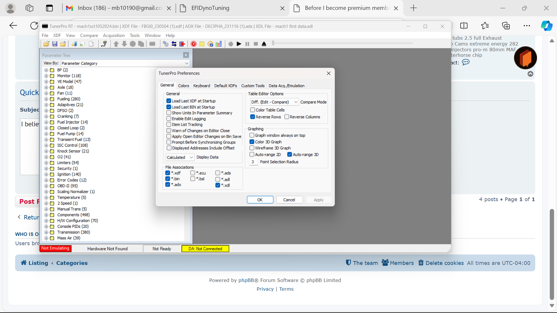

Before I become premium member, I wanted to get a head start on getting the QH installed on my new to me 04 Mach1 which currently has a SCT tune. I loaded the latest XDF and ADX file into the Tuner Pro RT read and stored the SCT tune as a bin file.
Next I returned the pcm back to the stock tune via the handheld SCT read and stored it as a bin file
I made the changes in the stock tune file via Tuner pros so I can start the car and begin tunning. But have a no start...
Now for my issue key on theft light flashes no start...
But! I can load the tune file I saved from the SCT into the QH and it starts.
Not sure why this is..

sounds like your stock tune read didnt read correctly

I’d guess that your sct bin file is not compatible with the xdf file.
Use the stock bin, not the sct bin.
Just guessing.
Just guessing.
- Posts: 6666
Re: Before I become premium member,
tunerpro setup is on the homepage
your stock file or read out file will need to be converted to use with fbgi0

Ok so my 04 Mach1 5 speed tear tag# on my pcm is TMX2
How do I get my stock file or read out file to get converted to use with fbgi0?
Thank you, MB,
Thank you, MB,
- Posts: 6666
Thats an fbfg2 file you can use that older xdf if you desire.
Otherwise ill have to convert it.
