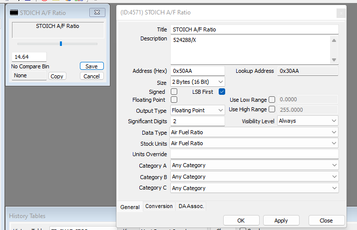

Thanks to wwhite I am adding some parameters to A1C as needed. Setting the Stoich AFR Scalar to 10:1 helped my e85 tune nicely. Please add to your next revision.
- Posts: 6572
Re: A1C XDF Additions
added will be in next update
