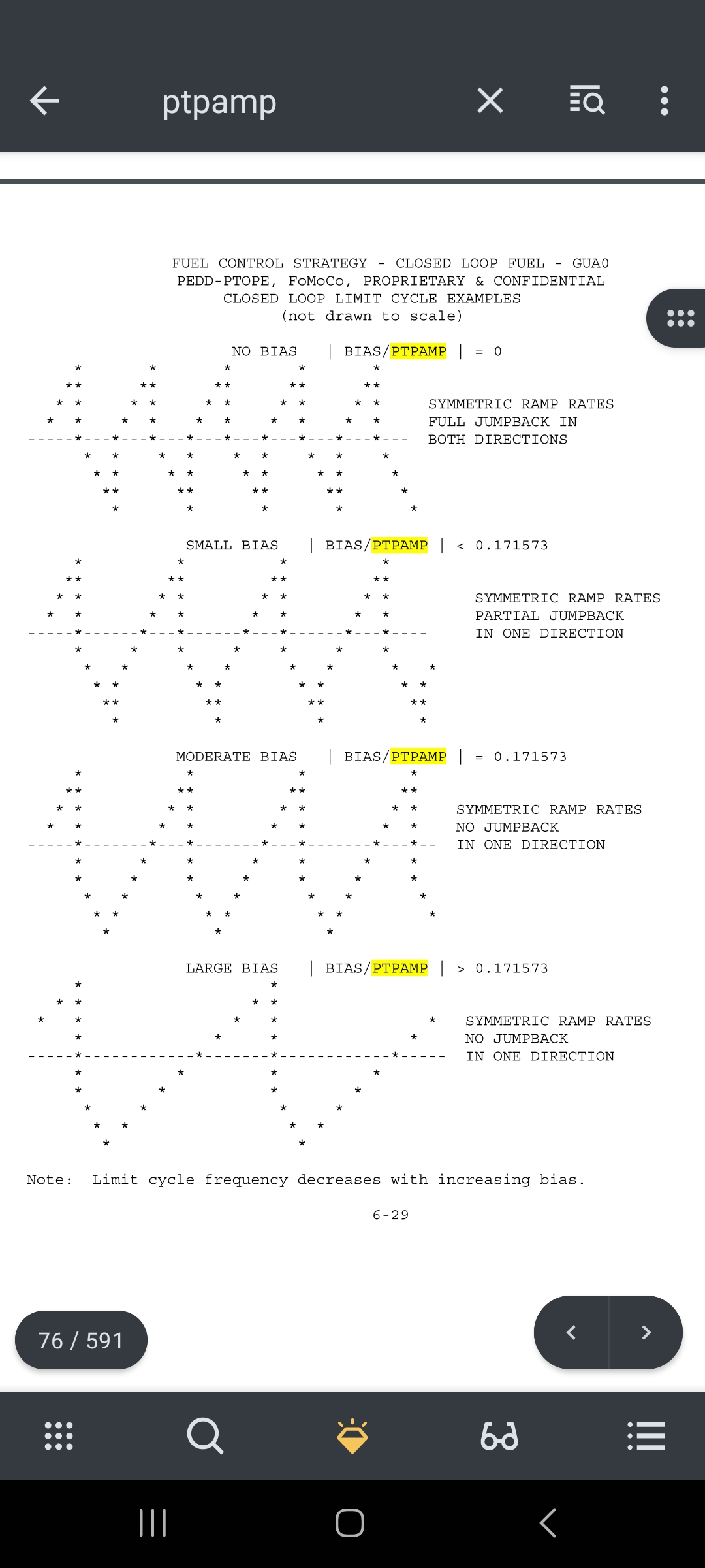

I have the full CBAZA documentation which includes the info you posted. It does not offer a solution that is understandable like the other two equations directly above and below that equation in the document do. I guess no one else whom has viewed this post understands it because no one has offered an explanation that indicates what the adjustment subtracted from stoich is for a given, negative BIAS_G/PTPAMP.
FOR NO BIAS |BIAS_G/PTPAMP| = 0
The limit cycle has full jumpback on both sides of stoichiometry and uses
symmetric pulsewidth ramp rates.
FOR SMALL BIAS 0 < |BIAS_G/PTPAMP| <= 0.171573 (0.171573 = 3 - SQRT(8))
The limit cycle has a partial jumpback on one side of stoichiometry to
achieve biasing and uses symmetric pulsewidth ramp rates.
FOR LARGE BIAS 0.171573 < |BIAS_G/PTPAMP| <= 0.45
The limit cycle has no jumpback on one side of stoichiometry and uses
asymmetric pulsewidth ramp rates to achieve biasing.
