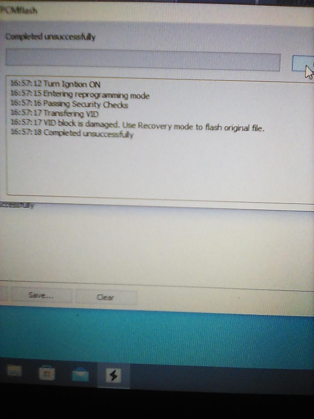

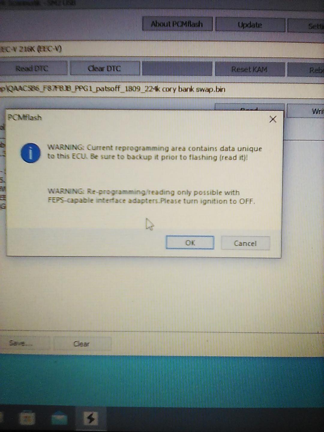

Late yesterday, I had on the bench before me the $20- '98 Explorer V-6 test PCM. Almost 2 weeks ago it was the very first PCM that I "read" with TunerPro RT and the Moates Quarterhorse. The next experiment would be to convert the 256k 0-1-8-9 bin file to 224k 1-8-0-9. After conversion "write" it back over itself in the test PCM. My results were an unsuccessful "write". I got this message and another. The pics may not be in order.
I really didn't expect any issues. I assumed, (and I have had to assume a lot during the "learning" process. Sometimes I'm right and sometimes I'm not),
I assumed that the bin file converted from TunerPro 256k to PCMFlash 224K that it would be a simple process to write it back over the original bin file contained within the PCM. I'm glad that I do have a test PCM to experiment on.

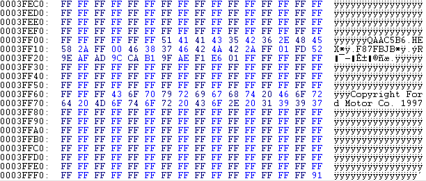

Also a question about PCMFlash. In using module #29, when the program is open, on the selection list it says EEC-V 216k. I didn't notice that during the first 2 PCMFlash OBD2 reads. Is there a 224k vs 216k issue? or does it just say that being "European" software? The read files are 224k.

I think that I got it. I went to settings and configured them such.

They list as 216k cuz thats actually what it is rom wise, 224k includes ram and 256k contains all the filler for actual flat addressing. Its actually russian software.
