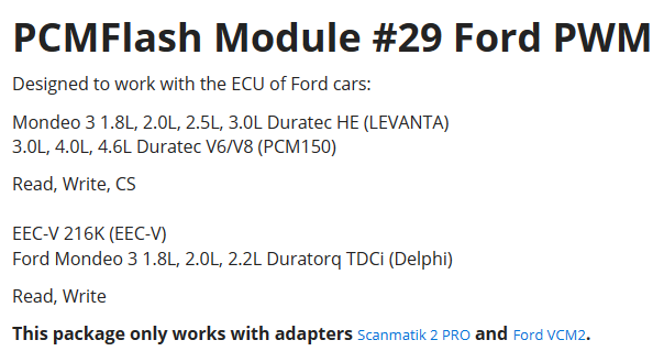

Also a question about PCMFlash. In using module #29, when the program is open, on the selection list it says EEC-V 216k. I didn't notice that during the first 2 PCMFlash OBD2 reads. Is there a 224k vs 216k issue? or does it just say that being "European" software? The read files are 224k.

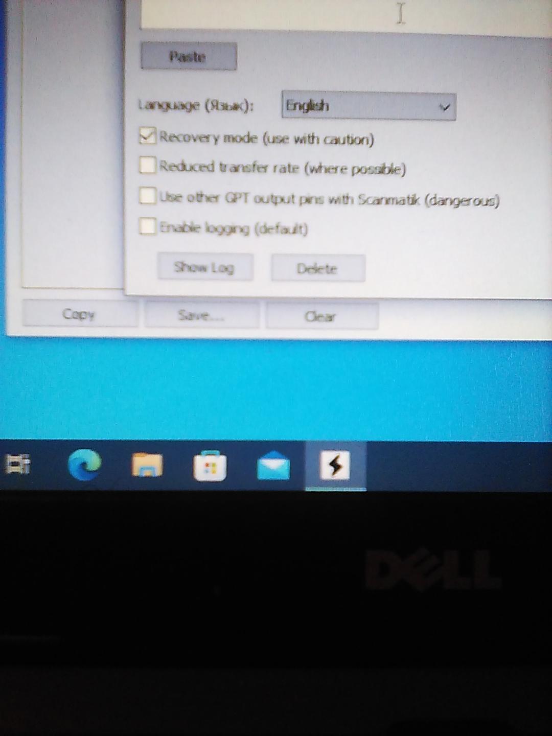

I think that I got it. I went to settings and configured them such.
The next test may or may not work. My current "driver, beater" is a '97 V-6 4.0 SOHC. The PCM is from a '98 4.0 OHV. I'm going to see if a 4.0 SOHC engine will run on a 4.0 OHV program. An Explorer friend said it will work. I'm about to see sometime today. The firing order is the same so I don't think I will mess anything up trying. The stock PCM will be put back in after the test.

They list as 216k cuz thats actually what it is rom wise, 224k includes ram and 256k contains all the filler for actual flat addressing. Its actually russian software.
