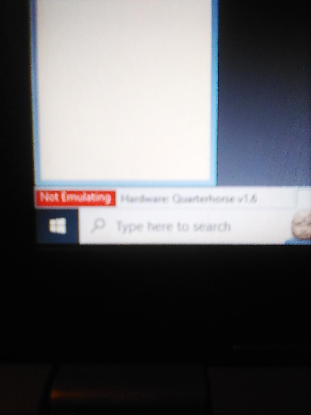

On a related but slightly different topic, the other night I downloaded TunerPro RT and I assume all of the correct software for the Moates Quarterhorse but even though my laptop would chime when I plugged in the QH, the TunerPro RT wouldn't show that it is seeing the device.
QUESTION: Should I attempt to load all of the software again? FTDI etc? Thanks for your patience. I didn't grow up with computers, so I ask a lot of questions about that too.

its not supposed to connect when you plug it in
did you click the initialize hardware icon?
do you have tunerpro setup correctly as per the write up?

I thought that I set it up correctly. I was using this laptop to read the directions as I set it up on the designated laptop. I may or may not have clicked the initialize hardware icon. Early tomorrow morning on a fresh brain I will give it another try. The Moates QH battery is not too hard to install but getting it out of the holder is a bit more difficult. I took it back out while it is sitting. I will let you know how it goes. I was trying to find (again) some archived Moates files to read up on the Quarterhorse and its capabilities. I clicked on the Moates.net link and of course it is dead. If I stumble across those archived web pages again, I will let you know. Thanks
Re: TunerPro RT playing adx file
Oct 28. I opened TunerPro RT and then plugged in the Moates QH. Then I clicked the "initialize emulation icon" and it recognized the device. It sees it. I must have all of the software loaded properly. I look forward to using this real time.
