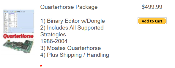

@red5.0fogger I purchased this package from Core tuning. The Moates wasn't available by itself.
When my QH arrived, the BE was taped to it.
I know my way around TunerPro a bit.

I can totally understand that. I am curious as to how this BE product works because I also recently made a purchase for another QH and the flash from core. I intend on flashing the best base tune I can put together and want an extra QH just in case. I should have listened to Decipha warning about Moates products not being available forever… I would be glad to help if I canATPCR wrote: ↑2023 Oct 17, 21:10 @red5.0fogger I purchased this package from Core tuning. The Moates wasn't available by itself.
I know my way around TunerPro a bit. I just wanting my BE dongle and software because I purchased it.

I think all the eec-v stuff for BE is all pay for from core. The dongle is for the license to use the software. I have no idea what all they have going on now as I hadn't used it in almost 10 years.
Re: Moates Quater Horse availability
Michael, That would have been nice to know about the Moates QH before I spent over $500- purchasing one from C#*e Tuning. I was forced to buy it with BE with a dongle that I will never use. What is the BE part of it worth to sell off the BE w/dongle? Is it something that someone would purchase from me to resell?
