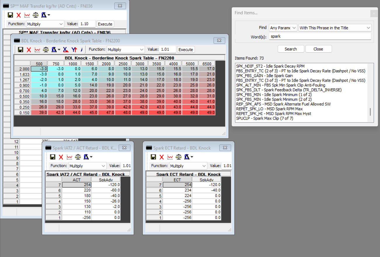

With that being said if I'm commanding 17 degrees in the Borderline table but only getting 14 degrees actual what is causing this. Surfed the timing write up as well as all retard functions that I could find and not seeing reason to be losing actual spark. Log and file attached, mid range the actual spark drops and doesn't follow the BDL table.

Yea I think I've found the right ones, They don't look like they would be limiting anything the way there set up. When I had ACT sitting around 100-120
deg f I lowered the 130deg cell value then also found out those cells get divided by 10 which would be 0.2 and I'm seeing a bit more then that.

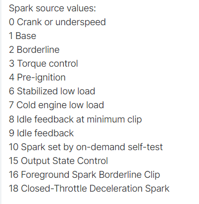

I also found this list of spark source values online, Guessing this is accurate data when looking at actual spark.

So with that being said what value is more important to watch on the datalogger, Actual or Borderline. I mean if actual is actual and I'm only actually getting x amount of spark ignition timing then is that where I'm lacking in the power production department. What would be removing a few degrees of spark, I read it uses the lowest values and it looks like the Borderline spark table is lower then the MBT table, MBT table looks healthy and I can't see that coming into play, also read your cals should be using the borderline table and obviously adders and subtractors.

Neither.
actual is what the cam sensor says you have, it could be wrong though.
borderline is what you should be commanding.
saftot is the actual commanded spark and what you should be looking at.
