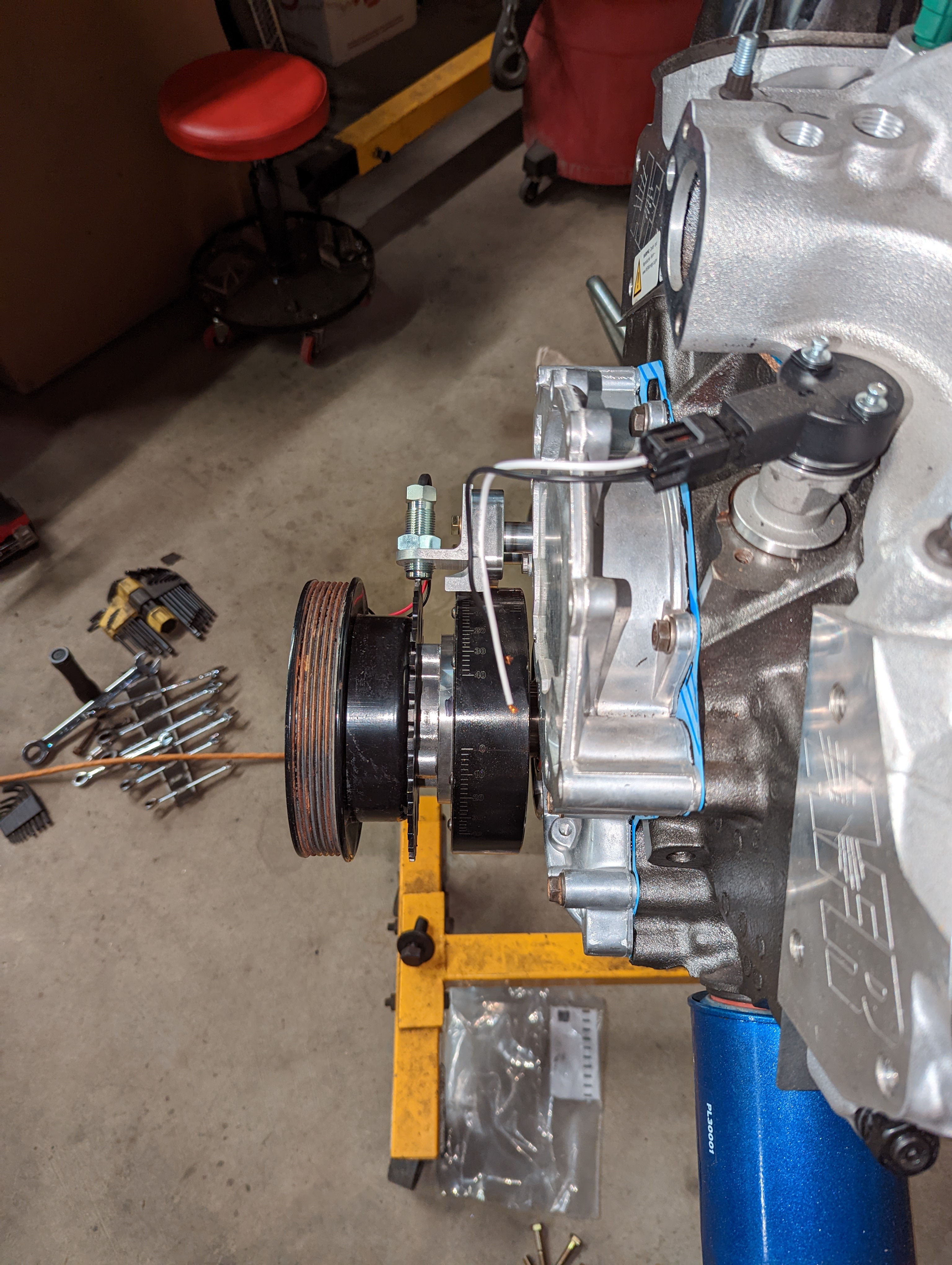

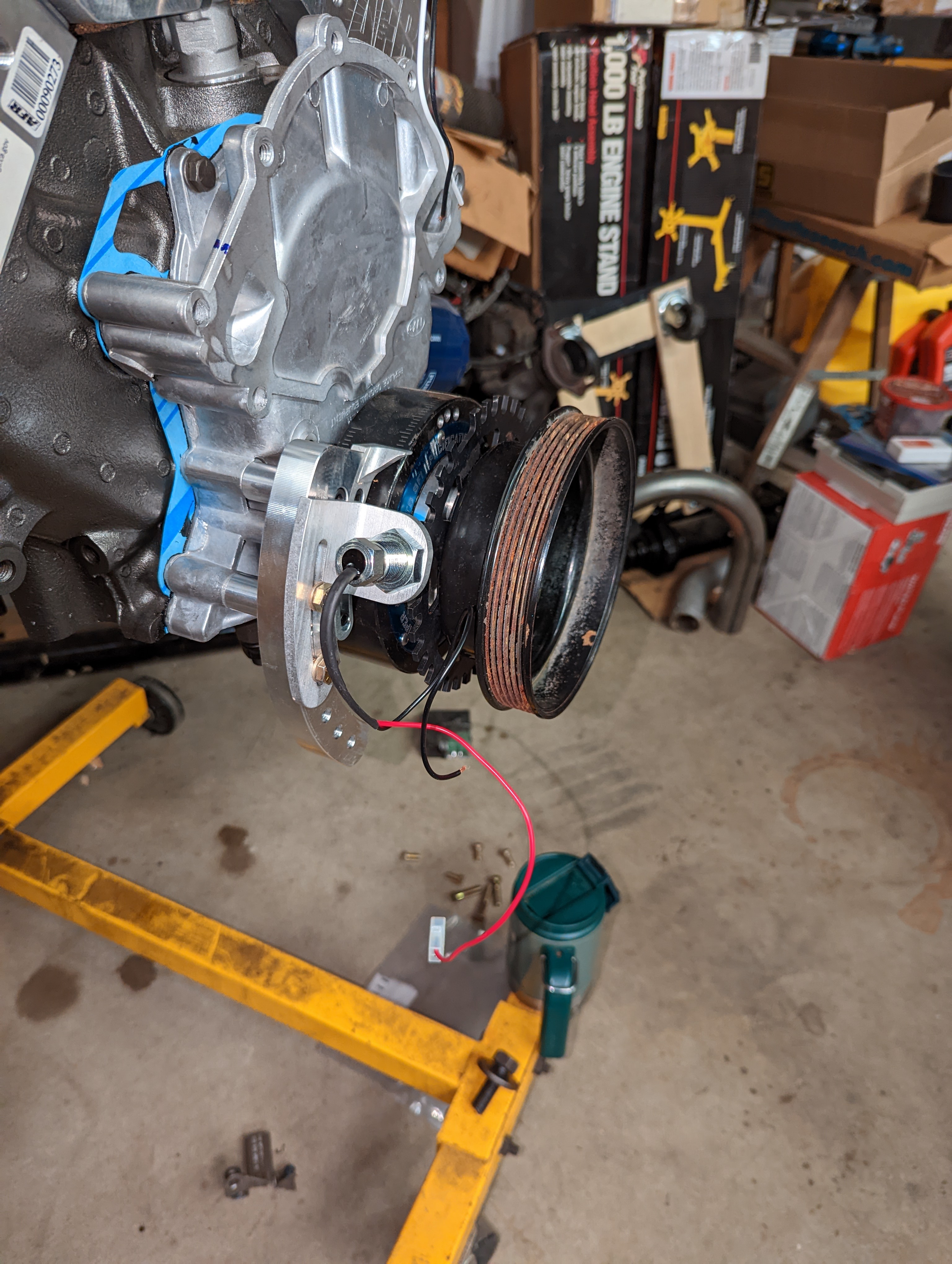

Re: Crank trigger angle
Here's what I'm in the process of doing on my 408, but I'm not too sure of the "stick out", beings it will be in a desert race Ranger (rocks, etc). Might eventually notch the backside of the balancer and fab a similar bracket. It will be easy to slide the pickup to adjust. Instead of there, you could mount anywhere in the 360° circle, as long as it's in the correct relation to the missing tooth.
