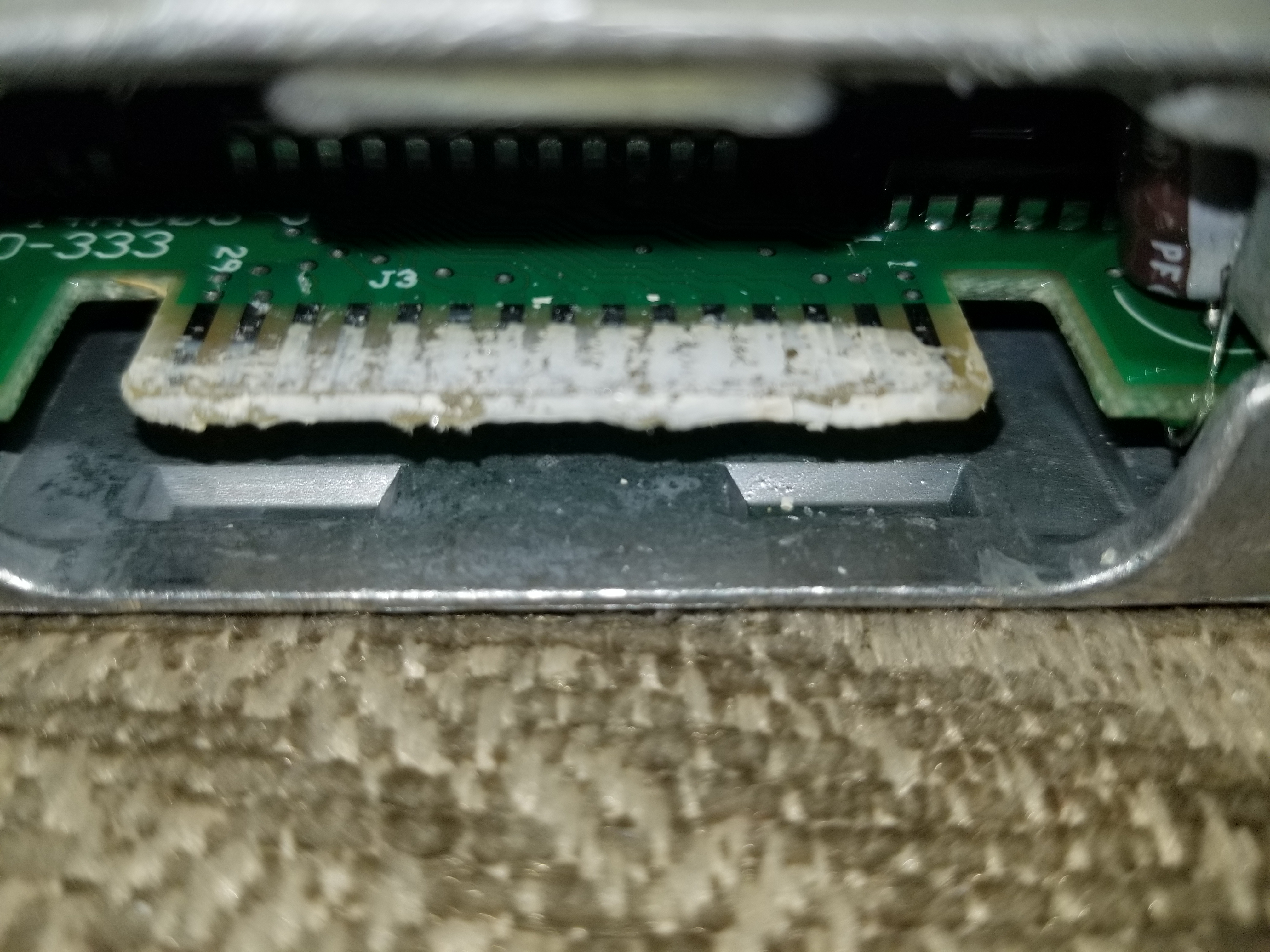

Is this normal J3 "goop" or am I looking at corrosion?

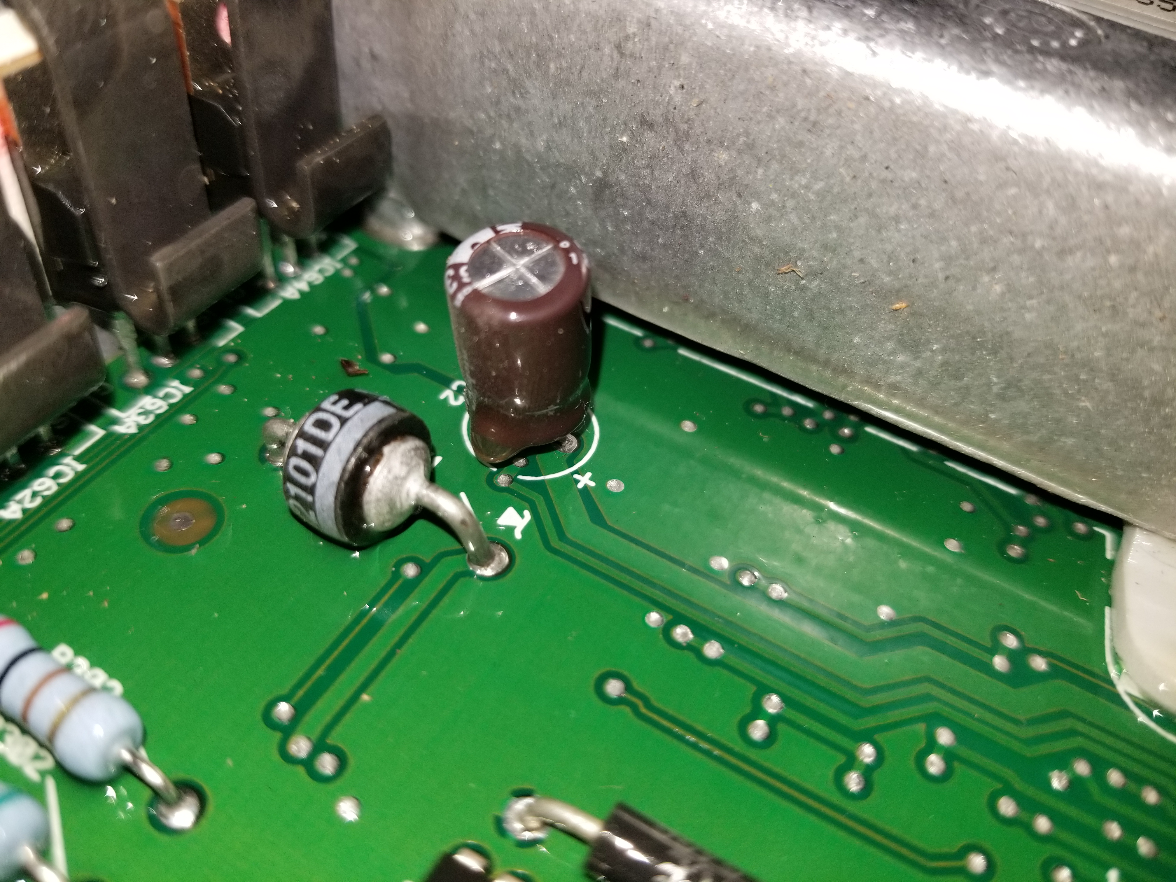

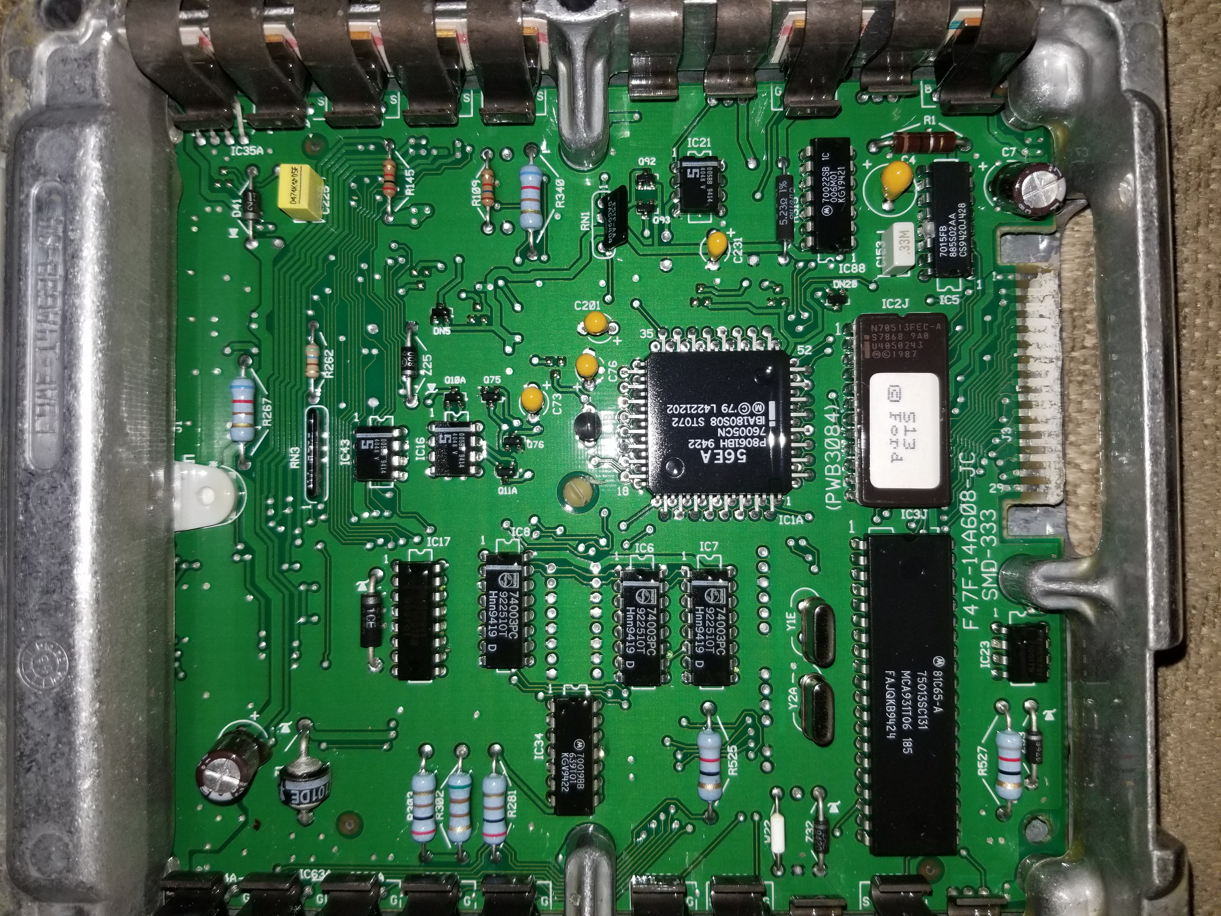

Since the wiring seems to be good, MAF seems to put out correct voltage, I'm strongly suspecting a bad PCM. No obviously blown caps, but one looks suspicious, large one closest to main connector opposite the j3.

That cap in the second picture looks like it is bulging at the bottom.

Agree that cap looks like it's bulging at the bottom, will probably throw in another PCM ASAP and see how it behaves. Kind of expensive unless I can find one in a junkyard locally.

Regardless, sounds like I've got a bad cap that is causing bad readings. Will either order new caps or a used EEC, probably just the EEC for the sake of getting this car done and running properly as quickly as possible.
