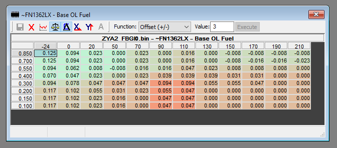

I think i found some of the corruption in the ZYA2 bin. I believe its in the fuel tables. Doing a compare of the AMZ2 and ZYA2 bins i found that the fuel tables are completely different. Im not sure if its supposed to be this way or if its corrupt. Maybe Decipha can chime in. Ill post pics of the fuel tables.

bad86capri wrote: 2022 Dec 22, 12:01I think i found some of the corruption in the ZYA2 bin.
The difference you are seeing is because you are comparing the tables using the 'Show Compare Difference' option. If you use the 'Show Compare Bin Data' option on it's own you will see the values are not that much different.

Can you elaborate more? Im not familiar with the bin data.

Deselect the 'Show Compare Difference' button to the right of the 'Show Compare Bin Data' button (the scales icon).

Let me clarify. im aware of the toggle button. i meant the actual bin data.
