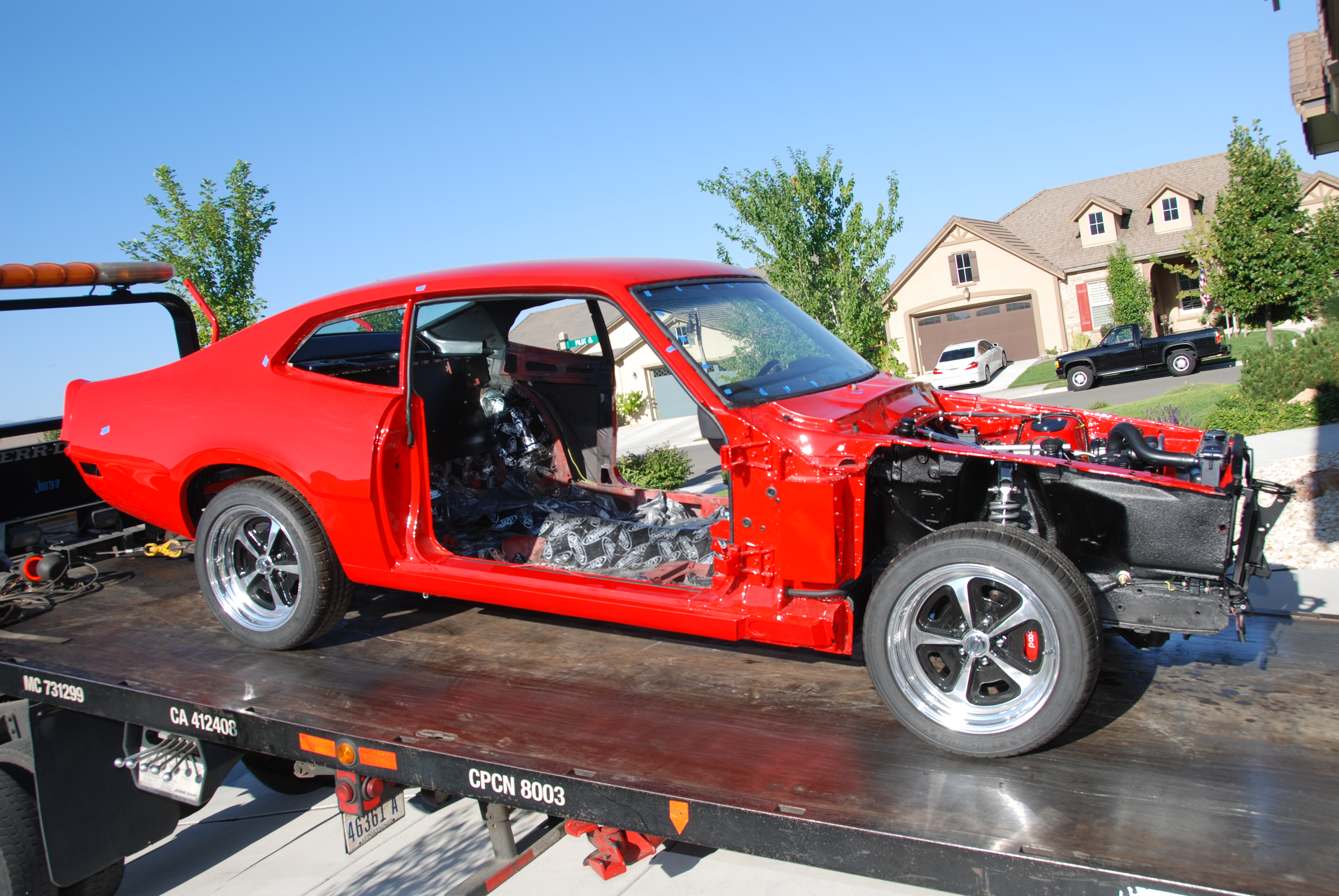

Well, that was fun. My computer is in a real fun place to get to. Ford didn't give the Maverick any extra room. To install the computer, we cut into the A pilar/front fender area just behind the firewall. We then made a box that sits in the space between the fender. (see picture) The computer and the fan controller just barely fit in there with half of the access blocked by the AC condenser box. Thankfully, I barely had enough room to partially open the door so that I could remove the side panels to access it. Then I got to contort myself to reach up, pull it all out, change the battery and jam it all back in there.
Uploaded the tune and she fired up on the first try.
Now, I can move her and get better access to put it all back together the was it was.
