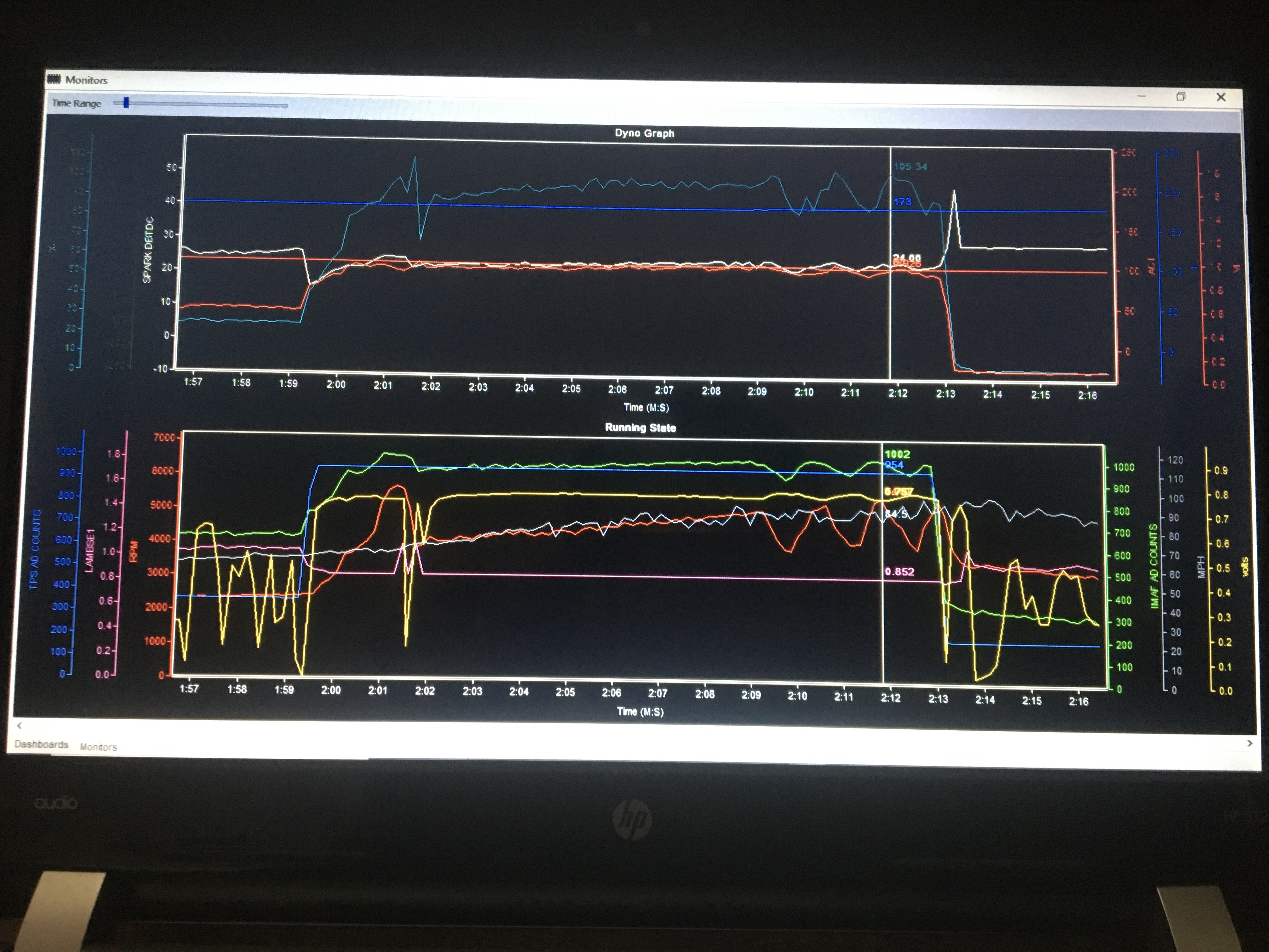

Ok,changed both of those to 1 and was a little better. Was able to rev it to 5k rpm before it did it again. Anything else I could change? I stay it in it when it did it. Log shows rpm dip to 4K then comes up to 5k repeatedly. INJ DC hit 107 this time. Notice it does it once it hits 100 INJ DC or above. Same effect as RPM with IMAF and INJ DC. Would post log but not letting me

LOG VIEW
LOG VIEW

sounds like it could be fuel system. Low fuel flow would show up more in high gear, long pulls.
100 injector duty cycle is a problem. What size are they?

19 lb injectors set @ 50psi base pressure
Tried to squeeze out some more out those 19s

well that's settled. 19s are too small. As proven by you having seen 107% duty cycle. You can't open an injector more than 100% of the time.
