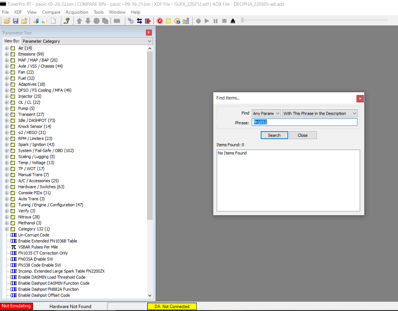

well I feel a little dumb because the maf backflow correction isnt actually doing anything to help as much as I initially thought it did. fn1052 doesnt exist in this strat and searching decel and wot airmass correction didnt net me any results either.
any other suggestions for me to try? I was on it a bit the other day and went into a decel and when i stopped the rpms dropped she started to surge and finally the rpms kicked up to about 2k and took quite a long time to come down.

Ok I’ll search for it again and report back. Do you know what it’s under in the parameter tree? I just used ctrl f to search for it last time

back to the laptop and I still cant find it?

Any other suggestions for me on this? I even opened up last years xdf and didn’t find fn1052 in there either?
- Posts: 471
Re: Controlling lambse on decel
Try searching for Manifold fill, manifold volume or VE correction. 1052 in CBAZA has that in the description as well, maybe he didnt put the actual function number in the description.

thanks for the suggestions. theres manifold slow fill and fast fill but no volume or VE correction. ive messed with the manifold fills in the past and dont think they did much. the MAF backflow correction description sounds like it should take care of this but I went as far as cutting the numbers in half and it didnt help.
I just found DNPPM(declutch dashpot) that sounds like it could help so I'll give that a shot next.
