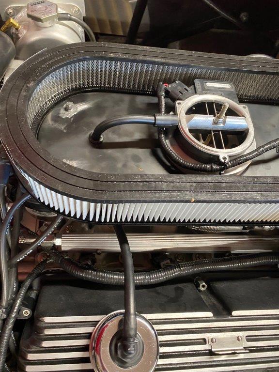

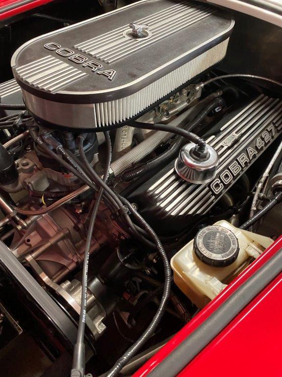

Re: 351C Multiport EFI conversion help needed
Here's what my 351w based motor looks like:
Mine's not actually one of the now defunct Mass-Flo-Efi systems but originally an Edelbrock Pro-Flo II system, converted to mass air with the modified GM MAF and the secret ingredient (frequency to voltage converter) to make the signal Ford EFI compatible.
I have a soft spot for Clevelands, having built a few for stock car racing in the eighties, but their advantages then have been overcome by technology and availability of Windsor style components. I just don't think they are worth the extra cost, time and fitment issues. If you want to, go for it!
Sean
Sean
