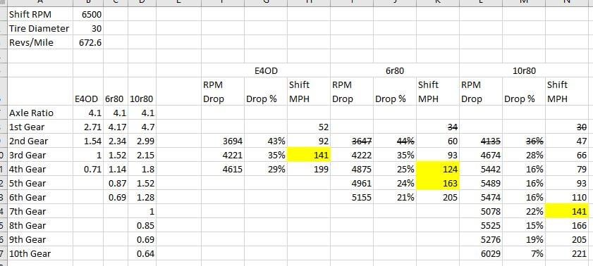

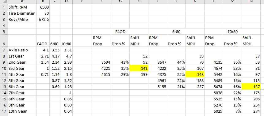

did some math... with a 4.10, 1st gear looks useless with a 10r80 and maybe even a 6r. I think a 10r would need a shorter axle gear or lockout 1st gear. RPMs stay in the sweet spot for my centri though.

Man I really like the way the 10r looks with keeping the 4.10 and 2nd gear launches!
