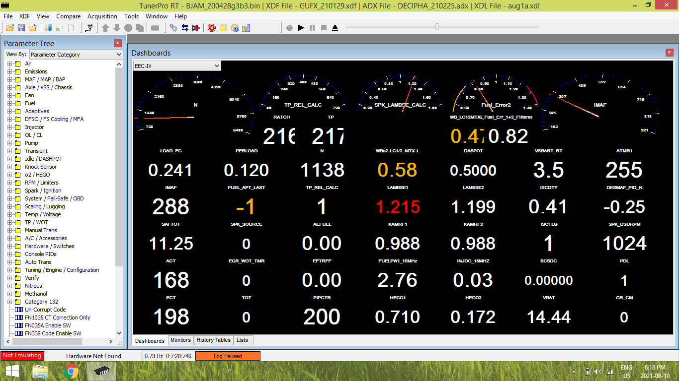

Also, going back to fuelling, here are a couple of screen shots. One shows KAMRF in the .700's. So, if I understand this right, I'm in closed loop, so HEGO's are monitoring the AFR in the exhaust pipe, the ECU is asking for a LAMBSE of whatever is entered in the MAF table(yes?) and the KAMRF’s are making the correction to reach the targeted LAMBSE. Is that right?
What is making the KAMRF think it needs that much fuel removed when LAMBSE is currently showing close to 1.0. That's where you want LAMBSE and KAMRF to stick around.....is that correct?
In the other screenshot it shows LAMBSE at around 1.200 with KAMRF providing virtually no correction. What is going on there that makes KAMRF not add fuel to fix it?
Incidentally, both instances happen at about 300 IMAF.
Just not sure if I'm seeing something off, or if all is good.

You lack some conceptual understanding of the basic open/close loop operations and how the maf based ecu works.
The factory O2s are narrow band sensors. This means that they are basically designed/calibrated to measure a lambda value of 1 (stoic). The can’t measure much more or less than stoicism (hence narrowband)
This means they are only used in “closed loop” fueling mode when the ECU is commanding a lambse of 1.
The ECU varies fueling slightly to get the 02 signals to switch (lean/rich) right around stoic.
The trimming of fuel required to get those narrowband O2s to “switch” is learned and that’s basically what the KAMRF represents.
The MAF is the primary sensor input to the ECU to help it calculate fuel needed. (Mass of air measured + mass of fuel needed = desired air fuel ratio)
There is a base fuel table, it is populated with lambse values . Lambse value of 1 only used in closed loop operation because that’s all the narrowbands O2s can report.
Lambse is a derivative of the air fuel ratio. There is an AFR scalar that has a stoic value for the fuel your running.
The ecu commands lambse of 1. By measuring maf counts and referencing the maf transfer function it now believes X mass of air is entering engine, it then references the fuel injector model and calculates how much injector pulse is needed to deliver Y mass of fuel to achieve stoic. Or lambda of 1
Again, It varies fueling to get that narrowband to report and adapts or trims fuel for corrections.
So now we know that if our base fuel table has lambda values less than 1 like .8 for example, then the ecu is in open loop or ignoring the narrowband O2 sensors because they are useless for measuring anything other than stoich. This is why a wideband is needed so that we can measure outside of that “band” near stoich if our ecu is commanding lambse less than 1.
We also know that O2s only measure or react to oxygen. They are useless and do not measure fuel. Incomplete combustion and/or air leaks into the intake or exhaust all will negate the ability of the narrowband O2 sensor to provide useful data to the ecu and you as the tuner.
If we are tuning we are operating on the assumption that the setup is mechanically sound first and then adjust maf transfer and or injector model to “calibrate” the operation. If there is an underlying issue, the calibration will be incorrect. You can’t reverse engine something that doesn’t work right to being with and expect good results. This is basically what we are doing with the data we know is correct and working backwards to solve for example, a larger maf sensor.
Hope this helps

I just wanted to add that I lack understanding as to why the ecu would command a lambse greater than a value of 1. My best guess is that in this case it expecting fuel vapors from the tank are being introduced to the intake manifold via the vapor management valve. Maybe someone who knows could address this concept of lambse great than 1 being commanded by the ecu?

My second best guess for a Lambse greater than a value if one means the ECU has calculated that the engine is in an excessively rich condition and trying to compensate. Again, maybe someone more knowledgeable can chime in on this topic.

ispibr and isckam have been combined by decipha recently and they are now logged as desmaf and in the same spot on the dash.
in the second screen shot the throttle is closed so you are in decel and why the lambse is at 1.2, I wouldnt pay much attention to that. The ecu will command whatever lambse is needed to get the hegos to switch. once dialed in they will bounce back and forth around 1 so seeing them above 1 is normal.
m-barans has given you good explanations and also keep reading the write-ups until things start to click, I know it took a long time for me to get a handle on things.
knowing more about your setup would help giving suggestions on what you should do. also i see your a premium member so wont Decipha be tuning this for you and showing how?
If you have known injectors and all their data is in the tune correctly then you need to dial in the maf transfer. to do this you need to be steady on the throttle and hold each imaf point for at least 10 seconds to allow it to stabilize. I assume you have a Decipha base tune so you should easily be able to use the histogram which will make this much easier, its the first one on the list and set it to running average. I would suggest resetting your KAMs and turn the KAM update off at this point until you get it dialed in. Find a nice stretch of road that you can run and try to hit every point on your MAF curve from idle to as high as you can comfortably go letting each one stabilize for at least 10 seconds. multiply the MAF transfer by whatever number is in the histogram once you have a good amount of samples at each point. In the end you should be able to get your KAMs to stay between 1-1.03 while lambse bounces back and forth around 1. You always want to be adding fuel so keep the KAMs above 1.
You can also use the KAMs to dial in the curve if they are mature but this will take a while so its easier to use the historgram. Use the KAMs to fine tune the curve to perfection after the initial dial in. To use the KAMs, in your example above with lambse's around 1 and KAMs at .7 you need to go to the 300 imaf count on the MAF transfer and multiply that by .7.
if you dont have known injectors with published data dialing in fuel can be a bit different and would require advice from someone with more experience. it is also discussed in detail in the write-ups. good luck and keep at it you'll start to understand it more and more.
