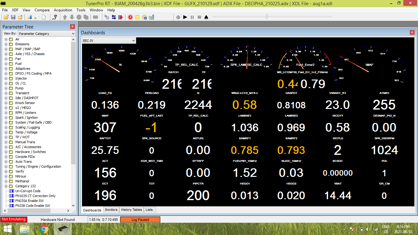

Also, going back to fuelling, here are a couple of screen shots. One shows KAMRF in the .700's. So, if I understand this right, I'm in closed loop, so HEGO's are monitoring the AFR in the exhaust pipe, the ECU is asking for a LAMBSE of whatever is entered in the MAF table(yes?) and the KAMRF’s are making the correction to reach the targeted LAMBSE. Is that right?
What is making the KAMRF think it needs that much fuel removed when LAMBSE is currently showing close to 1.0. That's where you want LAMBSE and KAMRF to stick around.....is that correct?
In the other screenshot it shows LAMBSE at around 1.200 with KAMRF providing virtually no correction. What is going on there that makes KAMRF not add fuel to fix it?
Incidentally, both instances happen at about 300 IMAF.
Just not sure if I'm seeing something off, or if all is good.

You lack some conceptual understanding of the basic open/close loop operations and how the maf based ecu works.
The factory O2s are narrow band sensors. This means that they are basically designed/calibrated to measure a lambda value of 1 (stoic). The can’t measure much more or less than stoicism (hence narrowband)
This means they are only used in “closed loop” fueling mode when the ECU is commanding a lambse of 1.
The ECU varies fueling slightly to get the 02 signals to switch (lean/rich) right around stoic.
The trimming of fuel required to get those narrowband O2s to “switch” is learned and that’s basically what the KAMRF represents.
The MAF is the primary sensor input to the ECU to help it calculate fuel needed. (Mass of air measured + mass of fuel needed = desired air fuel ratio)
There is a base fuel table, it is populated with lambse values . Lambse value of 1 only used in closed loop operation because that’s all the narrowbands O2s can report.
Lambse is a derivative of the air fuel ratio. There is an AFR scalar that has a stoic value for the fuel your running.
The ecu commands lambse of 1. By measuring maf counts and referencing the maf transfer function it now believes X mass of air is entering engine, it then references the fuel injector model and calculates how much injector pulse is needed to deliver Y mass of fuel to achieve stoic. Or lambda of 1
Again, It varies fueling to get that narrowband to report and adapts or trims fuel for corrections.
So now we know that if our base fuel table has lambda values less than 1 like .8 for example, then the ecu is in open loop or ignoring the narrowband O2 sensors because they are useless for measuring anything other than stoich. This is why a wideband is needed so that we can measure outside of that “band” near stoich if our ecu is commanding lambse less than 1.
We also know that O2s only measure or react to oxygen. They are useless and do not measure fuel. Incomplete combustion and/or air leaks into the intake or exhaust all will negate the ability of the narrowband O2 sensor to provide useful data to the ecu and you as the tuner.
If we are tuning we are operating on the assumption that the setup is mechanically sound first and then adjust maf transfer and or injector model to “calibrate” the operation. If there is an underlying issue, the calibration will be incorrect. You can’t reverse engine something that doesn’t work right to being with and expect good results. This is basically what we are doing with the data we know is correct and working backwards to solve for example, a larger maf sensor.
Hope this helps

ispibr and isckam have been combined by decipha recently and they are now logged as desmaf and in the same spot on the dash.
in the second screen shot the throttle is closed so you are in decel and why the lambse is at 1.2, I wouldnt pay much attention to that. The ecu will command whatever lambse is needed to get the hegos to switch. once dialed in they will bounce back and forth around 1 so seeing them above 1 is normal.
m-barans has given you good explanations and also keep reading the write-ups until things start to click, I know it took a long time for me to get a handle on things.
