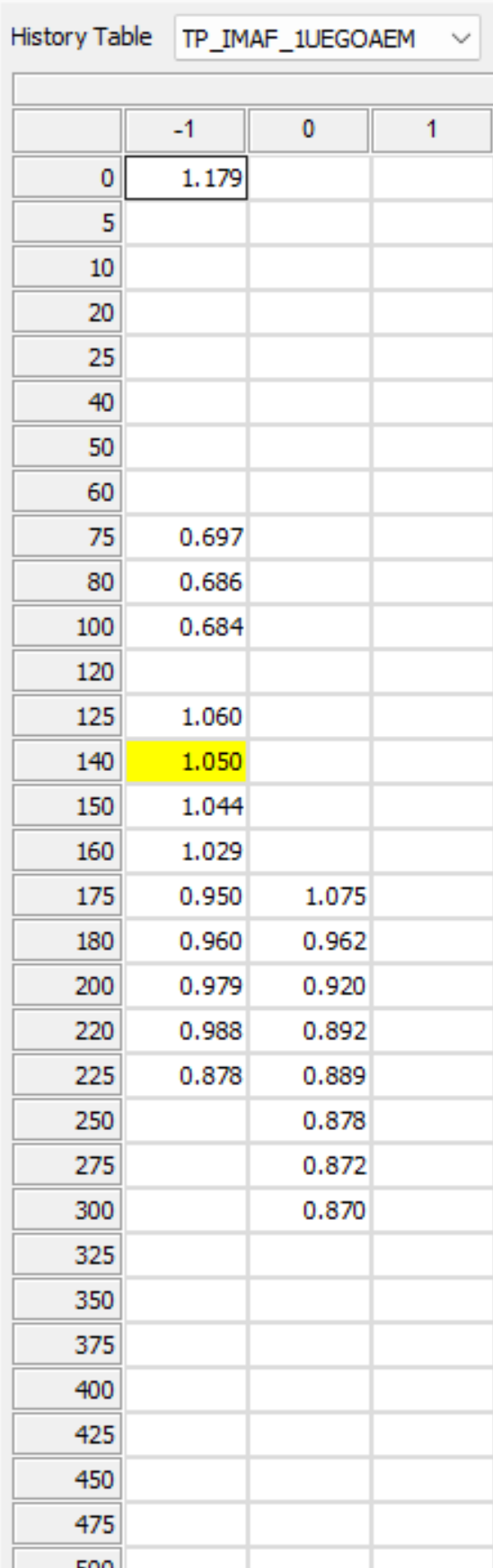

So quick update, I dropped back to the published settings for the Green Tops. Pulled in the published settings for the SCT BA 2400 MAF ... disabled Hego2, assigned everything to Hego1 and set about dialing her in ... now I have the Hego's plugged into both banks (in the LT header collectors) and the AEM WB in the Bank2 flow tube about 8-10 inches downstream of Hego2.
As I'm watching things I see Hego1 reading Lean and correcting with a lot of fuel ... and at the same Hego2 is pinned rich ... which the WB confirms. This discrepancy between banks is something that's been troubling me from the beginning. I understand the scavenging effect of the x-pipe but I'm don't have the experience here to say 'Yep, completely normal ... trust Bank1 ... and have at it" vs. "Something may be up indicates an underlying problem because at some point, the other Hego should start switching as well.
I decided to do try a few different things, and to rule out any issues with the harness and isolate any potential problems to the actual Bank ... I deliberately crossed over the Hego's. So ... now what the ECU things is Bank1 is actually hooked up to the Hego in the Bank2 collector. I restart my fuel dial from there ... The driver side Hego (now being read as Bank1) starts switching normally and giving me what I think are reasonable corrections ~5-10%, and the wideband is confirming everything is good ... however ... the passenger Hego (now being read as Bank2) is pinned lean. Reading pretty consistently at .150 or less. The only response I really see from it in terms of heading north of .450 is on a tip in. I'm going to attach a log in the hopes someone may be able to give it a quick glance and confirm:
1) Is this behavior completely normal, something you have observed with the scavenging effect of the x-pipe?
2) Is the passenger bank legitimately running that lean? Mechanical issue (Exhaust Leak, Clogged Injector, I already swapped out the Hego itself ... same result) I would mention vacuum leak but given I have been able to get the car to idle down quite low with the spout and IAC disconnected would indicate that I don't think the motor is drawing any unexpected air
3) Something else I may not be considering?
Don't mistake me here, not looking for easy answers and I'm more than willing to do my homework, trial and error .. but I also don't want to waste countless hours tuning around what could be an issue, only to find out on my first WOT run with the supercharger pushing air that that bank1 is in fact lean ... once when it goes BANG! :)
Here's the log, bin as well ... look forward to your input and wisdom.

- Posts: 6906
Re: Tuning the Injectors, Help with what's next
I have no idea what your seeing but I didn't see anywhere hego 1 dumped in fuel?
Your fuel error was no more than 3% in the entire log?
I have absolutely no idea what your referring to with any of this.

Sorry, the post may have been confusing.
That log is with the HEGO1 signal physically connected to the O2 Sensor on Bank2. Fueling error is minimal, however the behavior of the other Hego is what is concerning. It's lingering in .100 territory.
Previously with everything connected normally HEGO1 Signal connected to O2 on Passenger side, Hego 2 turned off. I was seeing much larger Fuel corrections based on the wBo2 readings taken on Bank2 while Bank1 says its running perfect fuel.
I've attached a previous log that should outline what I was seeing ...
- Posts: 6906
that log is useless it never went in to closed loop so the o2's never dialed in the fuel in for you to see what the errors were
