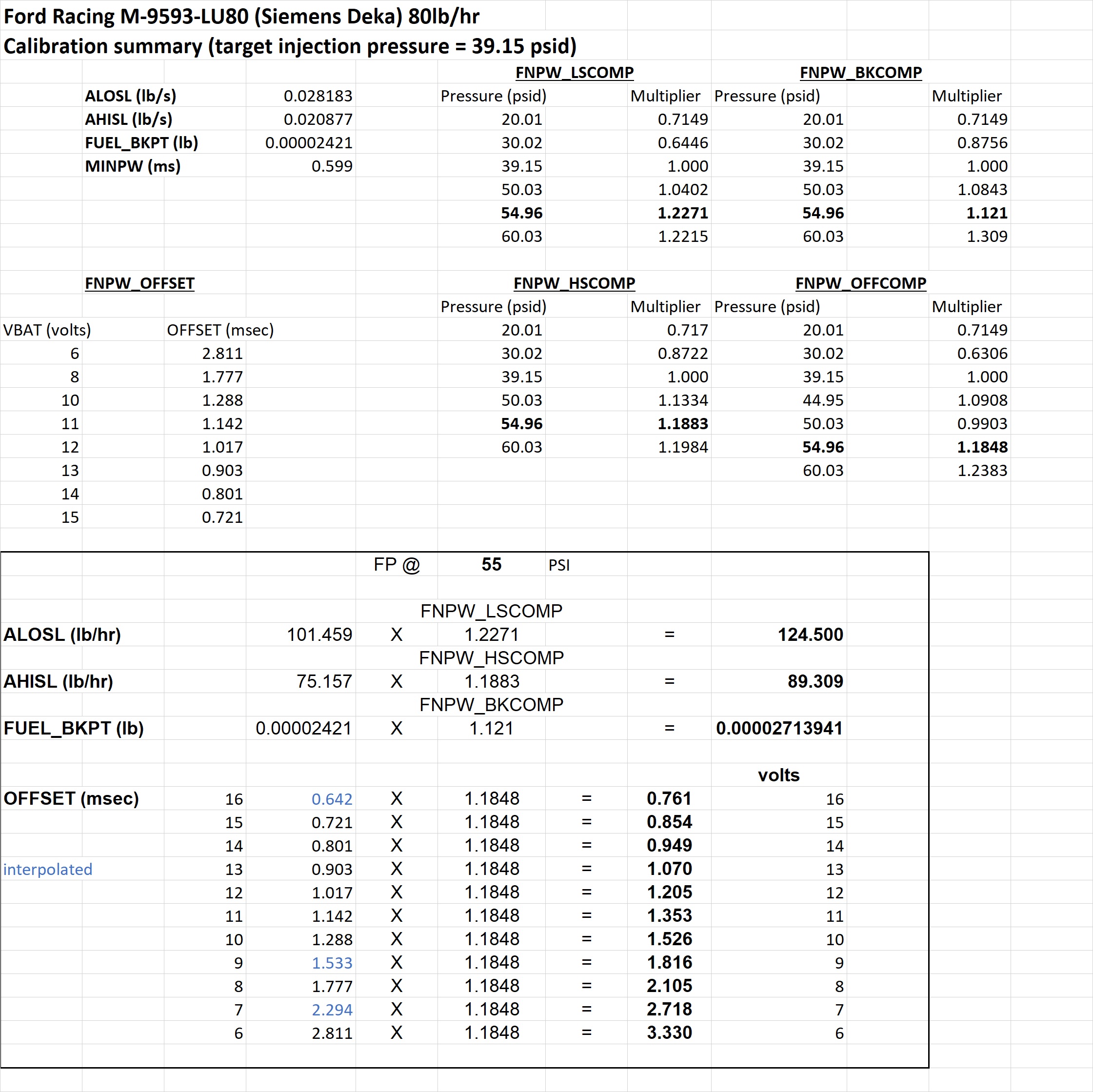

Interesting. I have the dark red (burgundy) color 80 lb/hr Siemens-Deka (shorty) injectors and was told to use the the M-9593-LU80 calibration summary (adjusted for actual fuel pressure). It seems to work OK but I'm never sure if I'm using the right data or not.
I'm attaching the injector data I used along with my adjustments for 55PSi base FP. Feel free to check my math! Let me know which calibration data you use and how it works out!

I've been talking to Chris on and off over the last few days. He said he has used the data provided by continental without issue and is seems to be accurate. I'm gonna try it but I'm not sure if I'll need all of those other variables for pressure changes in RZASA. I'm assuming I'll need those too for eec-v and that's not included in the continental data.

I’d love to hear how the Continental supplied data works for you. Please share your results when you’re able.
