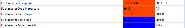

I haven't downloaded tunerpro yet, here is a quick snip of injector values- everything is scaled down and I believe under the limit?
- (6.24 KiB) Not downloaded yet
- Posts: 7111
Re: Lean tip in/Manifold volume questions
impossible to tell from that
did you factor in your deltap modifiers?

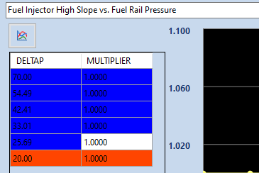

deltap was changed in breakpoint, high slope, low slope and offset vs rail pressure. they re all the same as this, and the multiplier is the same 1.0

- Posts: 7111
why did you null the deltap ?

- Posts: 7111
You dont have the fuel rail pressure sensor anymore?

- Posts: 7111
well righy now its useless.
You need the deltap since you have your fuel rail pres sensor so it compensates if your fuel pumps cant keep up to save the engine instead of blowing it up.
but yeah your under the clip limit so should just need to dial in the maf is all.
