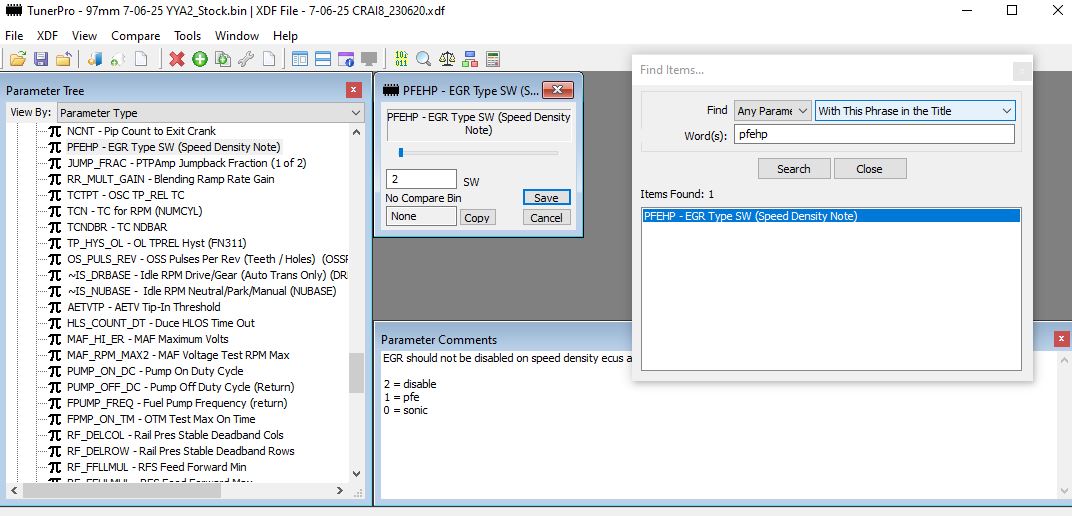

just simply disable the egr
pfehp
Posts: 289
Re: Recurring PO1409 using CRAI8
I currently have it set this way:
And this flag is set this way:

Posts: 7005
dont forget obdii_mil set it the same as obdii tst
Posts: 289
Well, I found 3 here kind of related. Do I set them all to 1 0r 0?
Posts: 7005
No, change it from 247 to 183 as it says.
Posts: 289
Thanks Michael, that fixed it!
