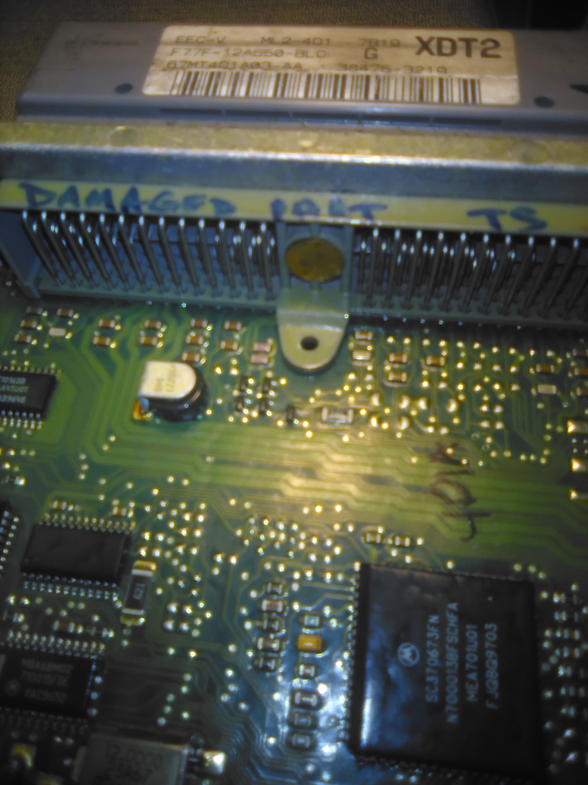

I think that I got an "F".
TP QH read of the #2 '97 pcm

I had a successful read on the 3rd '97 pcm. After #2 failed with all capital "F"s, after that I noticed that someone had used a blue marker inside of it and wrote "Damaged part".

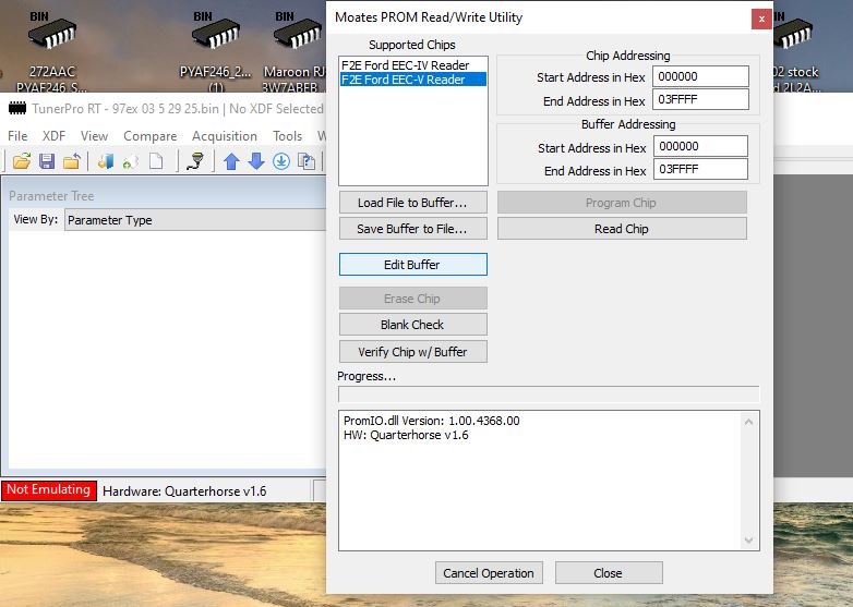

I have the Moates QH installed in a good pcm hooked up to the laptop with TunerPro RT running. I can access
Tools/
Hardware Utilities/
Moates PROM I/O.
It appears that the program and device are capable of not only "reading", but "writing".
I wonder if clicking the "erase chip" button will make the "program chip" button light up?
Michael, have you or anyone else used this feature before? Any guidance would be greatly appreciated.

- Posts: 6823
Re: XDT2 1997 Explorer 5.0 pcm
No, the QH cant write the ecu
