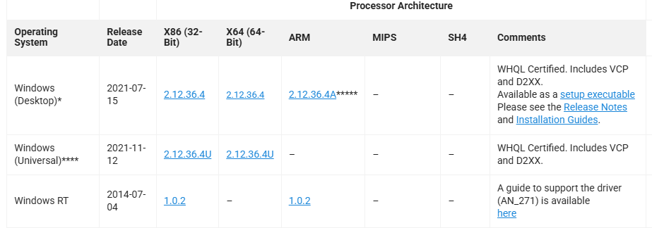

I'm going to take it out and test the battery first. Also, the FTDI driver may not be on this laptop. Which is best for this
Windows 10/11 laptop? Pic below with choices.

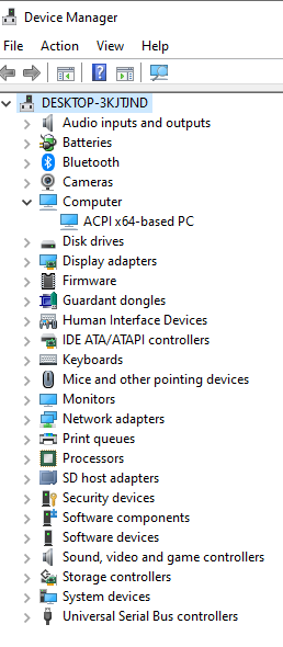

I have everything configured correctly in TunerPro RT. I have gone over the directions several times so I know that it is correct. Last night I downloaded and installed FTDI. I can search for it in device manager, but I can't find it or something that looks like what I think I'm looking for.
The laptop with TunerPro RT is open and ready but the QH and the laptop aren't communicating.

do you have the bin adx and xdf loaded in tunerpro?
in device manager under usb you should see the com port pop up and become available with the qh plugged in

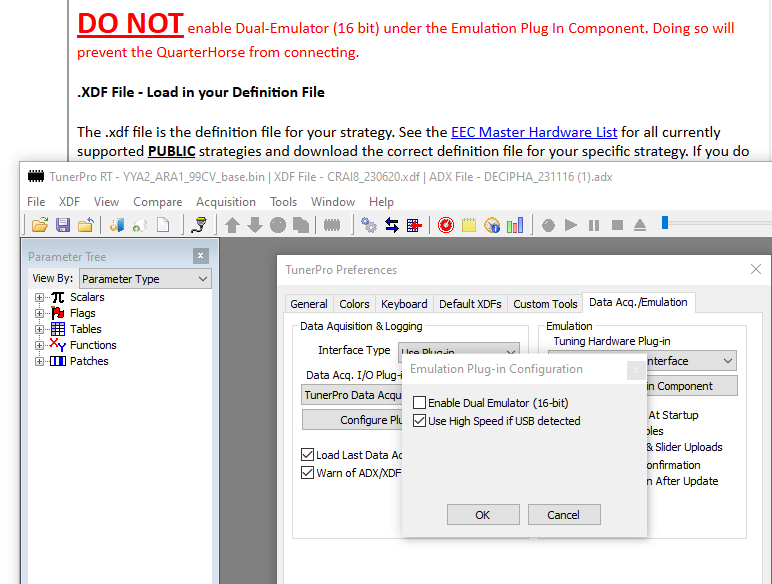

Re: No start with QUARTERHORSE
This may be the problem. I previously had this set correctly, but the TP RT update may have caused it to change.
"click configure plug in >> port type >> shared with emulator"
I'll have device Manager open when I get up from the table and go back to the vehicle. Checking all TP RT settings again too.

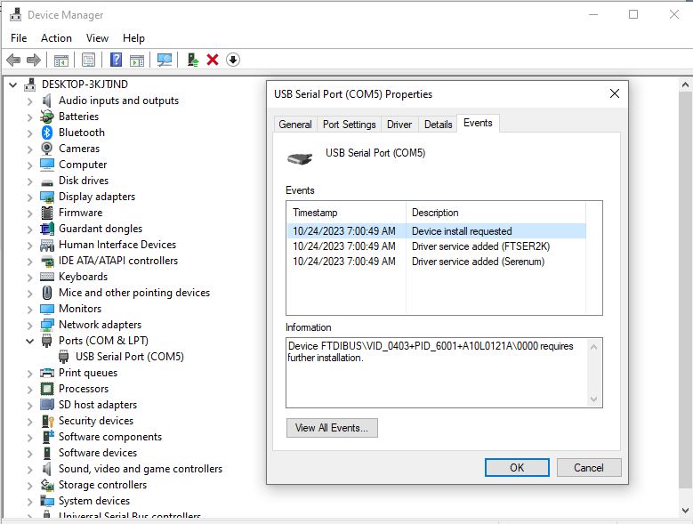

In the device manager, I could see an indication as I plugged the QH into the laptop. I'm not sure what is up. I'll go through everything again this evening. I have some physical mechanical work that I need to do while our temperature is at more of a humane level. Could the J3 port be just partially working or more likely that I just don't have one little thing configured properly? I'm able to follow your set-up directions.
I found one thing that I wondered about. In picture below.

Im into the USB serial port/FTDI part of this. I see that I may have one last thing to do to have this configured properly.
Document says "https://ftdichip.com/drivers/d2xx-drivers/ After you've downloaded the driver, you will need to go to device manager and find the ftdi device which is the qh. Plug the Qh in to make it appear. Click on properties and update the driver manually to the search path you downloaded the driver files to." The picture is of the point that I got to but I'm not getting the last step.
